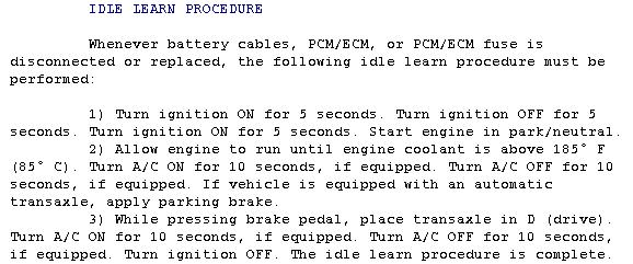

Tiz Posted August 31, 2006 Share Posted August 31, 2006 Din manualul de service al Matiz-ului: a incercat cineva asa ceva ??? Link to comment

tomis Posted November 4, 2007 Share Posted November 4, 2007 IDLE LEARN PROCEDURE Hyunday The procedure in the service manual was superseded by a more recent service bulletin. It says to turn the car complete off (remove the key), remove power from the ECM for 20 seconds and then start the car. Let it idle for 10 minutes. Shut it off for 20 seconds and then start it and let it run for 5 minutes. Shut it off again and you're done. The first 15 minutes of the procedure is to get the engine up to normal operating temperature. So an alternate method would be to warm the car up, shut it off, remove power from the ECM, and then run the car for 5 minutes and shut it off. Inainte de a vizita mecanicii fa un reset de ecm si un idle learn. Scoate cateva minute borna de la baterie. Apoi pune-o la loc. Apoi: 1. Pui contact 10 sec 2. Iei contactul tot pt 10 sec. 3. Pornesti motorul si lasi sa se incalzeasca pana la temperatura de regim 4. Pornesti AC-ul timp de 10 secunde. 5. Opresti AC-ul timp de 10 secunde 6. Pornesti AC-ul (treapta 1 la ventilare si buton AC) timp de 10 secunde. 7. Opresti AC-ul timp de 10 secunde 8. Opresti si motorul. Apoi mergi normal. From 2007 Honda Fit Service Manual, here's their version of the ILP: 1. Make sure all electrical items (A/C, audio, lights, etc) are off. 2. Reset the ECM... 3. Turn the ignition switch ON and wait 2 seconds. 4. Start the engine. Hold the engine speed at 3,000 rpm until the radiator fan comes on, or until the engine coolant temperature reaches 194 F (90 C). 5. Let the engine idle for about 5 minutes. (NOTE: if the fan comes on, do not include its running time in the 5 min.) Link to comment
Satori Posted November 4, 2007 Share Posted November 4, 2007 From 2007 Honda Fit Service Manual, here's their version of the ILP: Acel manual nu este unul oficial, Honda. Procedura respectiva nu ar trebui privita ca fiind litera de lege, dar nici ca fiind gresita. Link to comment
