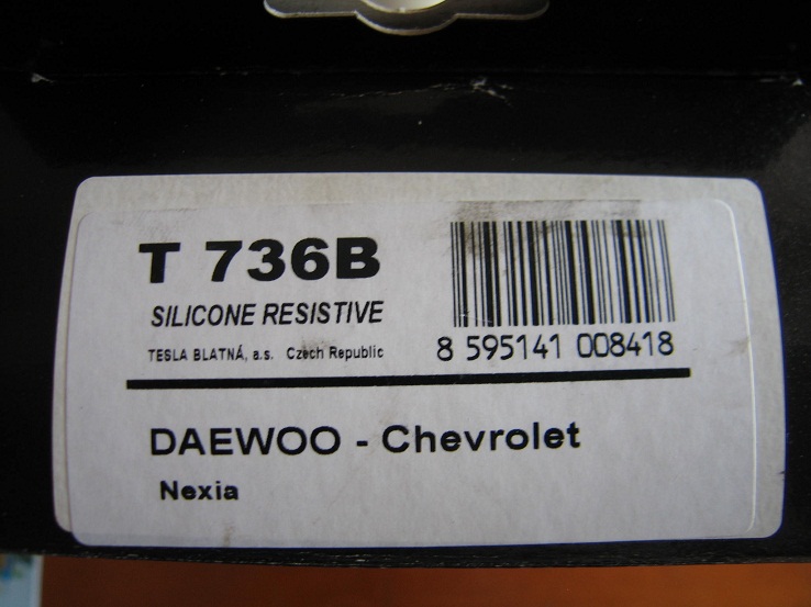

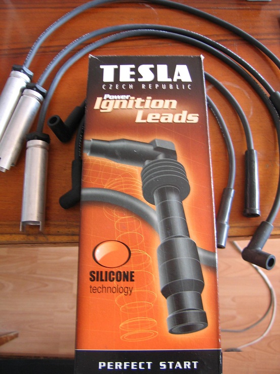

CFL Posted November 16, 2014 Share Posted November 16, 2014 Stie cineva un cod pentru fise bujii tesla?Am luat T711B si are o fisa mai scurta decat trebuie! Link to comment
Shift1 Posted November 17, 2014 Share Posted November 17, 2014 T 736B este pt motorul 8v, SOHC Link to comment
smv Posted November 18, 2014 Share Posted November 18, 2014 (edited) Daca ai motor cu 16v si aprindere electronica (fara distribuitor = delcou), codul T711B este cel necesar ... Edited November 18, 2014 by smv Link to comment
Shift1 Posted November 18, 2014 Share Posted November 18, 2014 (edited) On 11/18/2014 at 1:04 PM, smv said: codul T711B este cel necesar ... On 11/16/2014 at 9:52 PM, CFL said: Am luat T711B si are o fisa mai scurta decat trebuie! Edited November 18, 2014 by Shift1 Link to comment
CFL Posted November 19, 2014 Share Posted November 19, 2014 Deci aviz amatorilor:acea fisa mai scurta merge folosita dar intinsa la maxim existand riscul sa iasa acel morcov sau sa se rupa fisa in timp.Eu merg cu setul vechi de fise si cu imbusul in portbagaj. Link to comment
