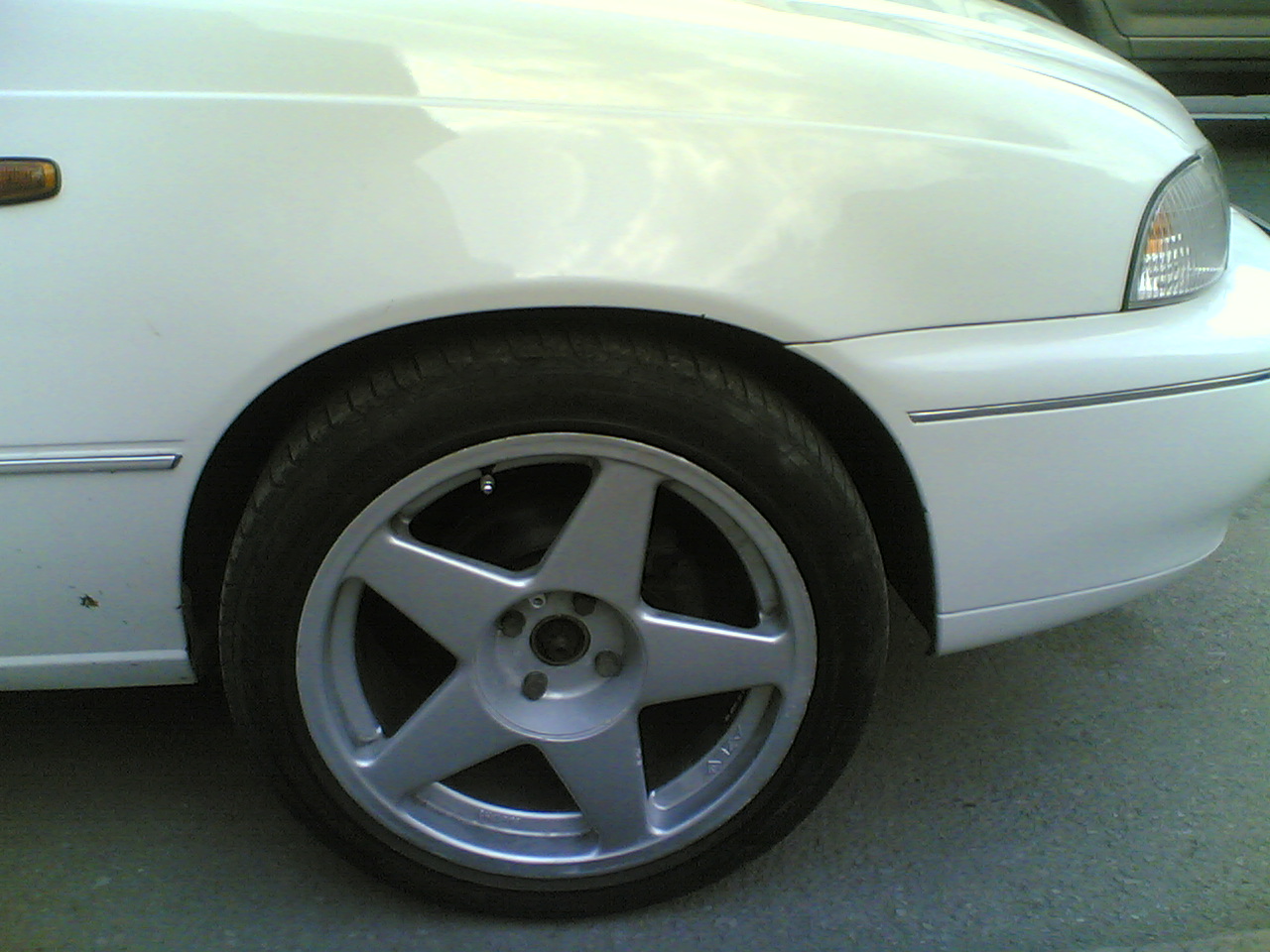

Satori Posted April 26, 2006 Share Posted April 26, 2006 Iote ce poti sa pui pe Cielo (nu stiu daca se vede prea bine... sunt de 17'') Link to comment
