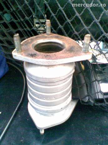

KumKum Posted July 2, 2012 Share Posted July 2, 2012 Asta e precatalizator. Si asta e racord flexibil. Link to comment
