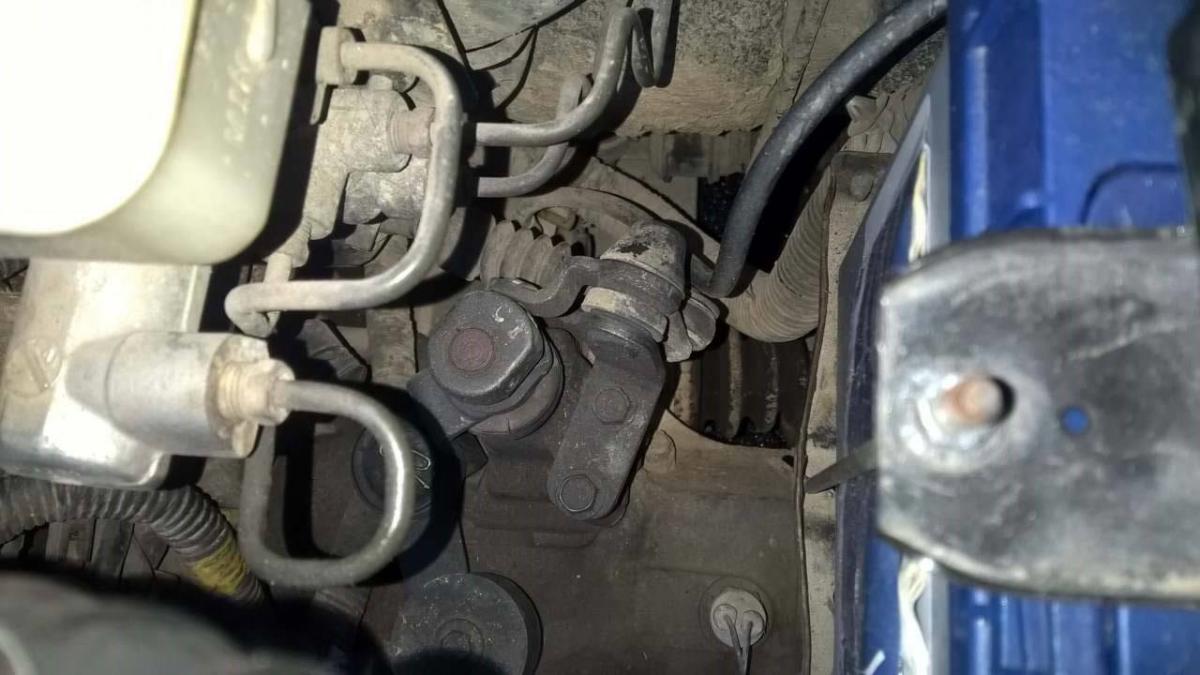

augustinionut Posted December 1, 2017 Share Posted December 1, 2017 Am nevoie de o poza ca sa identific pozitia corecta a timoneriei. a mea e in treapta 1. Link to comment
