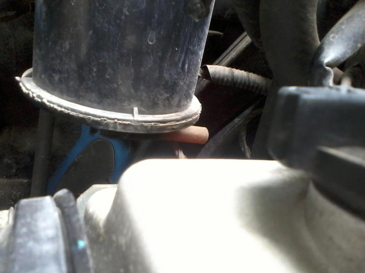

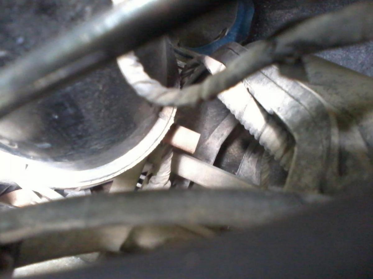

vrazvanc Posted May 25, 2013 Share Posted May 25, 2013 Am gasit sub canistra de vapori un furtun care nu duce nicaieri, aveti idee ce-i cu el? Link to comment
augustinionut Posted May 25, 2013 Share Posted May 25, 2013 Ala asa e,nu duce nicaieri. Link to comment
vrazvanc Posted May 25, 2013 Share Posted May 25, 2013 Multam'! As fi zis "furtun taiat", da' parca suna mai bine asa. Link to comment
tomis Posted May 26, 2013 Share Posted May 26, 2013 Ii zice furtunul de scurgeri al canistrei, probabil daca e ceva condens, o ia la vale Link to comment
vrazvanc Posted May 26, 2013 Share Posted May 26, 2013 OK, tomis, merci de explicatie! Link to comment
