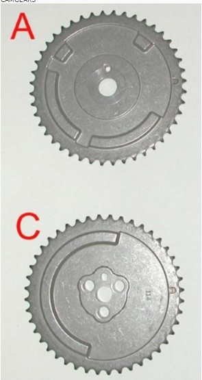

AmunDei Posted February 16, 2016 Share Posted February 16, 2016 (edited) Domnilor, ce timing gear are matizul (euro 4)? 1X sau 4X? Am gasit ca senzorul axei cu came este de tip VR (sau inductiv) dar nu gasesc aceasta bucata de informatie pe nicaieri. Mai precis care din cele 2 modele din poza pusa ca exemplu? Edited February 16, 2016 by AmunDei Link to comment
AmunDei Posted February 17, 2016 Share Posted February 17, 2016 Mi-am raspuns singur Discul nu are marcajele astea pe el, in schimb exista un rotor separat montat pe capatul celalalt al axei de tip 1X. Link to comment
