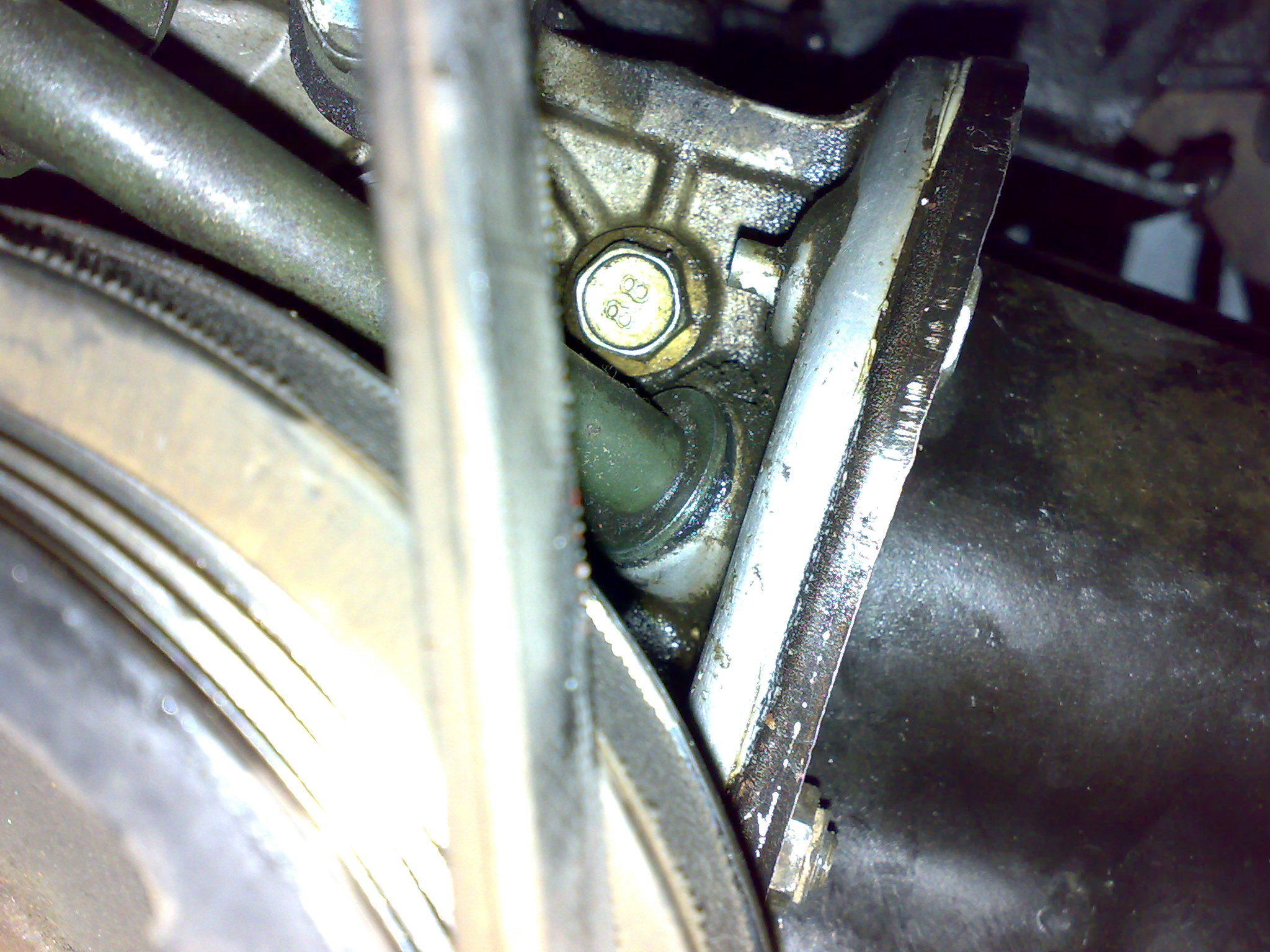

argon Posted June 19, 2010 Share Posted June 19, 2010 Nu cred ca mai dau baia jos, am gasit sursa de la care se umezea, aviz amatorilor, tubul de la joja are doar un semering, in rest joaca acolo, simeringul arata cum se vede, am pus silicon negru si gata. 1 Link to comment
