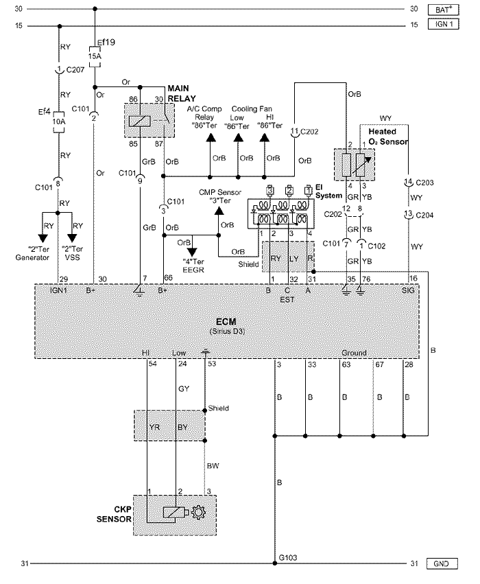

augustinionut Posted December 26, 2010 Share Posted December 26, 2010 Pune bani deoparte de un pet de bere si roaga-l pe tolin . O sa te indrume spre sumatorul lui abramburel, topicul cu turometrul pentru matiz euro 4, unde parca cred e data ordinea firelor la bobine. Succesuri Link to comment

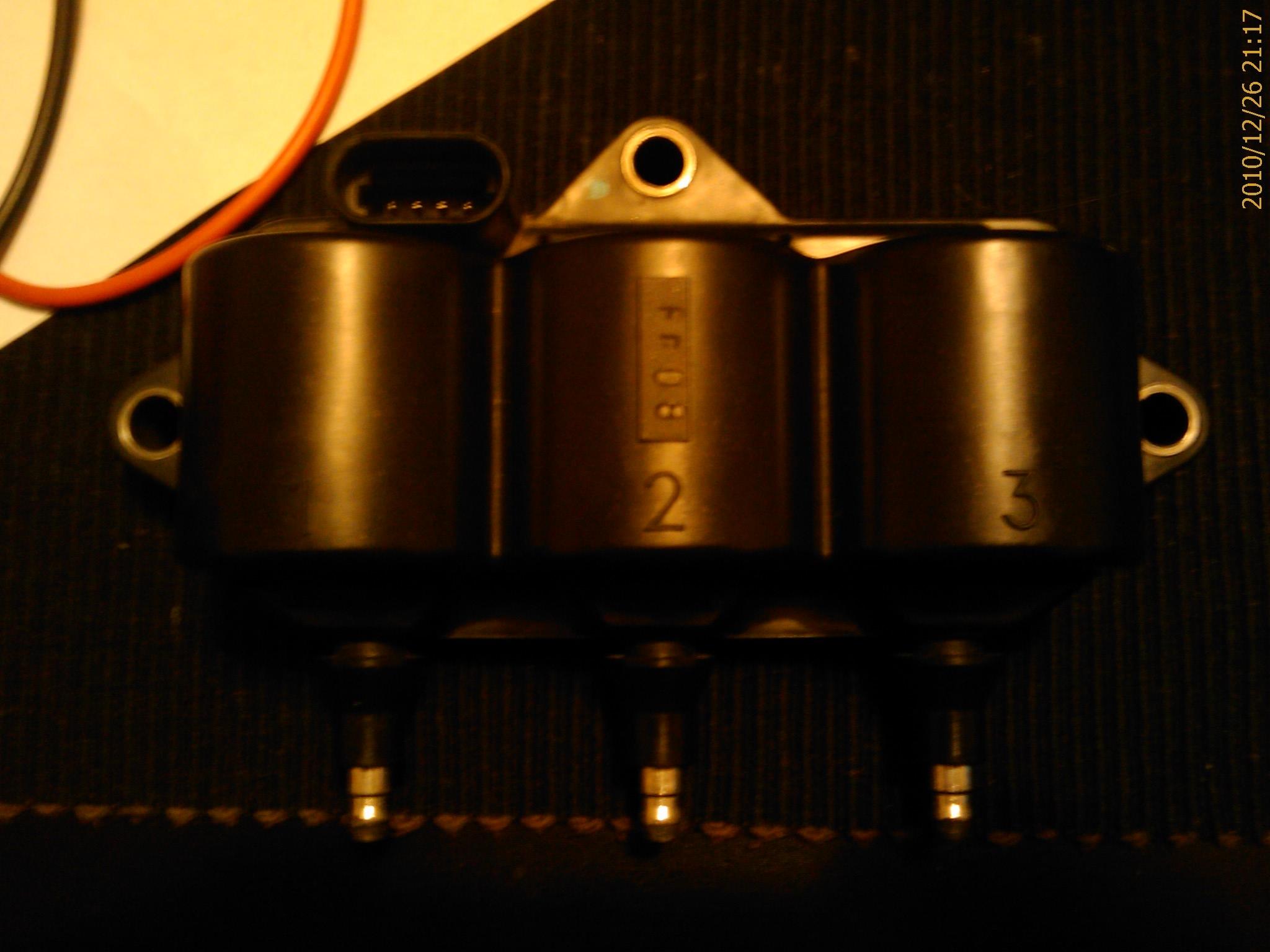

closchkutza Posted December 26, 2010 Share Posted December 26, 2010 Ok, am facut masuratori. Am ca plus cel portocaliu. Cifrele arata asa: + -> P1 - 0.6 ohm; P1 -> + - 0.6ohm; + -> P2 - 0.6ohm; P2 -> + - 0.6ohm; + -> P3 - 0.6 ohm; P3 -> + - 0.6ohm; ------------------------------------------------------- S1 - > P1 - 0ohm; P1 - > S1 - 0ohm; S2 - > P2 - 0ohm; P2 - > S2 - 0ohm; S3 - > P3 - 0ohm; P3 - > S3 - 0ohm; ------------------------------------------------------ + - > S1 - 0ohm; S1 - > + - 0ohm; + - > S2 - 0ohm; S2 - > + - 0ohm; + - > S3 - 0ohm; S3 - > + - 0ohm; P1, P2, P3 - primarele(firele A, B, C, din mufa, de la stanga la dreapta) si S1, S2, S3 - secundarele, de la stanga la dreapta. Ce fac mai departe? Link to comment
tolin Posted December 26, 2010 Share Posted December 26, 2010 Pinul 1 este comunul (plusul). Deci, masori: - 1->2, 1<-2, 1->3, 1<-3, 1->4, 1<-4 ; - 1->B1, 1<-B1, 1->B2, 1<-B2, 1->B3, 1<-B3. Este suficient atat. Link to comment
augustinionut Posted December 26, 2010 Share Posted December 26, 2010 (edited) Undeva ai gresit: De la secundare la primare se afla pe traseu diodele, care nu conduc decat in tr-un singur sens, deci nu are cum sa citesti 0 ohmi de la secundar la primar, si tot 0 ohmi de la primar la secundar, pastrand firele multimetrului in aceleasi maini. Zero ohmi inseamna traseu direct, scurt, diode strapunse etc. Edited December 26, 2010 by augustinionut Link to comment

closchkutza Posted December 26, 2010 Share Posted December 26, 2010 (edited) B1, 2, 3 = secundare, nu, adica iesirile spre bujii, nu? Si mie imi place berea aia )"> . Edited December 26, 2010 by closchkutza Link to comment
augustinionut Posted December 26, 2010 Share Posted December 26, 2010 Deci closckhutza n-a masurat oo-le, sau a inversat bornele multimetrului concomitent cu ale bobinelor Si n-ai gusturi rele la "bere". Eu prefer ginul. Tonic. Link to comment
tolin Posted December 26, 2010 Share Posted December 26, 2010 (edited) B1, 2, 3 = secundare, nu, adica iesirile spre bujii, nu? Asa. Secundarele trebuie sa fie de ordinul kohmilor. Edited December 26, 2010 by tolin 1 Link to comment

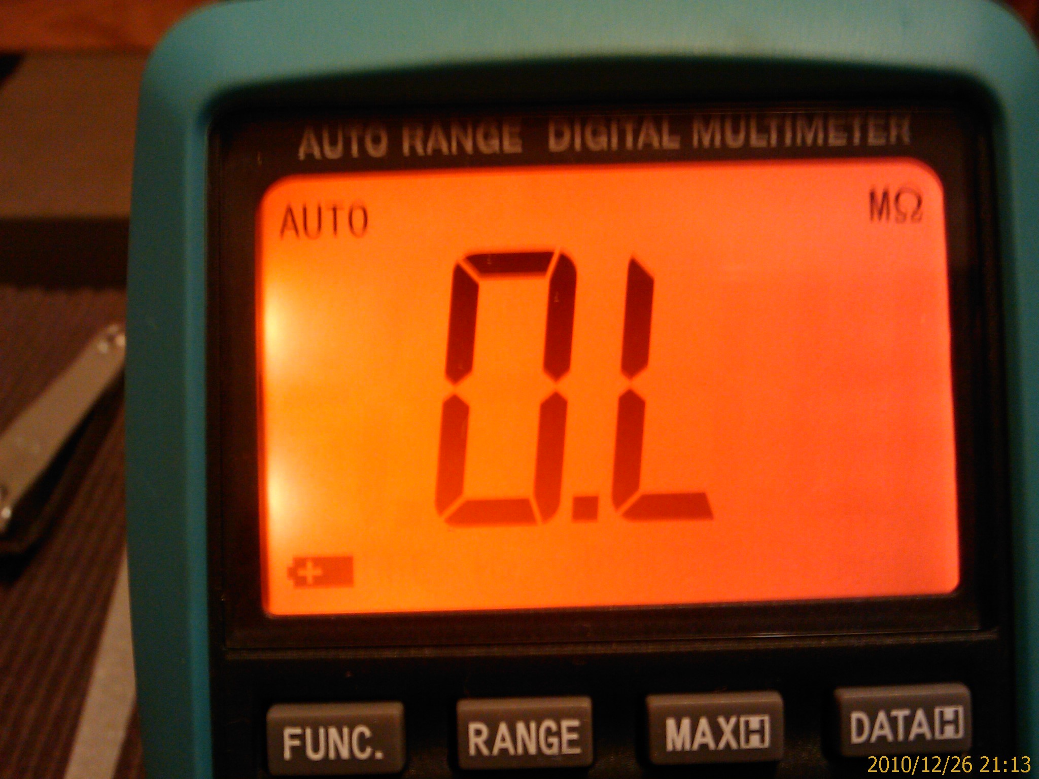

closchkutza Posted December 26, 2010 Share Posted December 26, 2010 Ok. am refacut masuratorile, asa cum a zis tolin. Sper ca am inteles bine, luand Pinul 1, de la stanga la dreapta(in pozitia in care se vede in poza) ca + si restul, in ordine 2, 3, 4. Asa cum am zis mai sus, B-urile le-am luat ca secundare, la fel, de la stanga la dreapta, incepand cu 1. Rezultatele sunt: 1 -> 2: 1,1ohm; 1 <- 2: 1,1ohm; 1 -> 3: 1,1ohm; 1 <- 3: 1,1ohm; 1 -> 4: 0,6ohm; 1 <- 4: 0.6ohm; ------------------------------------------------ 1 -> B1: 0.L(a se vedea in poza) 1 <- B1: 0.L (a se vedea in poza) 1 -> B2: 0.L(a se vedea in poza) 1 <- B2: 0.L (a se vedea in poza) 1 -> B3: 0.L(a se vedea in poza) 1 <- B3: 0.L (a se vedea in poza) Avand in vedere lipsa mea de cunostinte in domeniul asta, am luat 0.L ca 0 (zero). Ce inseamna cifrele obtinute mai sus? Multumesc pentru ajutor, tolin si augustinionut. Multumesc mult. Link to comment

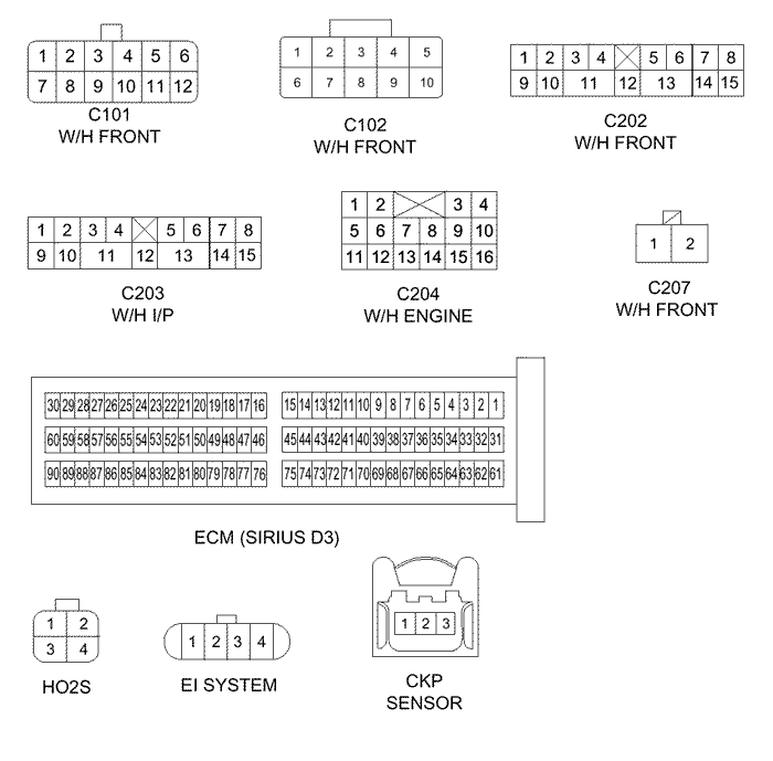

tolin Posted December 26, 2010 Share Posted December 26, 2010 (edited) In desen apare mufa de pe cablu, mama. Pinul 1, tata, din poza ta se afla in extremitatea dreapta ! Sa refaci toate masuratorile, nu e bune. Edited December 26, 2010 by tolin 1 Link to comment
closchkutza Posted December 26, 2010 Share Posted December 26, 2010 Ok, am refacut masuratorile luand ca pinul 1 primul din dreapta si pinul 4 primul din stanga(1, 2, 3, 4 de la dreapta la stanga). Cifrele sunt: 1 -> 2: 1,2/1,3ohm; 1 <- 2: 1,3ohm; 1 -> 3: 1,2/1,3ohm; 1 <- 3: 1,3/1,4ohm; 1 -> 4: 1,2/1,3ohm; 1 <- 4: 1,3/1,4ohm; -------------------------------------------------------- Pentru 1->B1, 1->B2, 1->B3 si invers sunt exact la fel ca mai sus. Link to comment

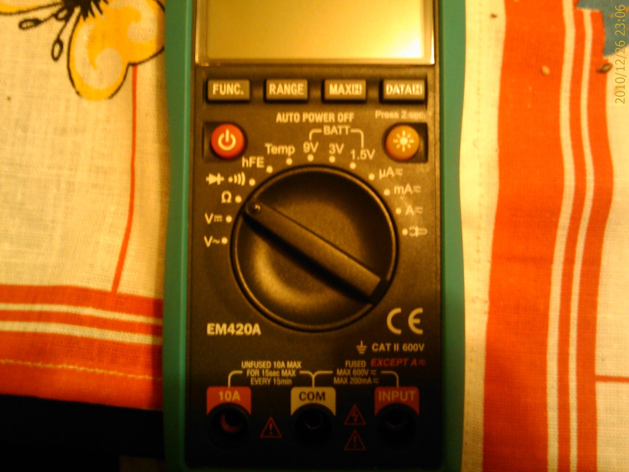

closchkutza Posted December 26, 2010 Share Posted December 26, 2010 Asa arata multimetrul. Din pacate nu stiu care este optiunea de care zici tu. Daca o are, zi-mi te rog care este. Link to comment
Salex Posted December 26, 2010 Share Posted December 26, 2010 Fix deasupra pozitiei din poza. Adica a 4a de la stinga la dreapta. Link to comment
closchkutza Posted December 26, 2010 Share Posted December 26, 2010 Ok, pe acea optiune sunt doua moduri de masura(prin apasarea tastei Func): unul in V si altul in ohmi. Pe cel in V primesc urmatoarele: 1 -> 2: 0.000V; 1 <- 2: 0.000V; 1 -> 3: 0.000V; 1 <- 3: 0.000V; 1 -> 4: 0.000V; 1 <- 4: 0.000V; Pe cel in ohmi primesc urmatoarele rezultate: 1 -> 2: 0.8/0.9ohm; 1 <- 2: 0.8/0.9ohm; 1 -> 3: 0.8/0.9ohm; 1 <- 3: 0.8/0.9ohm; 1 -> 4: 0.8/0.9ohm; 1 <- 4: 0.8/0.9ohm; De asemenea, apartul bipaie cand ambele fire sunt asezate pe pini. Pentru 1->B1, 1->B2, 1->B3 si invers sunt exact la fel ca mai sus in ambele moduri(.0L pentru modul in V si 0L. pentru modul in ohmi). Link to comment
tolin Posted December 26, 2010 Share Posted December 26, 2010 Din pacate, nu poti masura diodele celea cu aparatul acesta, valoarea curentului pe care-l injecteaza in montaj fiind prea mica pentru a deschide semiconductorul. 1 Link to comment
