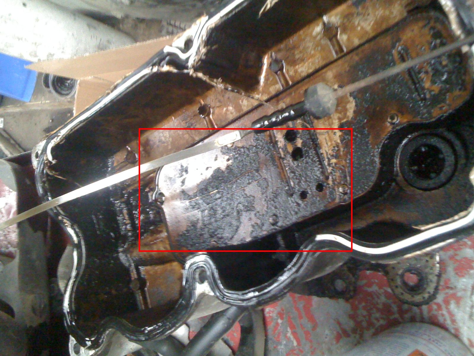

augustinionut Posted November 10, 2011 Share Posted November 10, 2011 (edited) Culbutori ce-or fi, sorry Cand am zis pe capac m-am referit prins sub capac.ASTA: Edited November 10, 2011 by augustinionut Link to comment
pisboy_sparxx Posted November 10, 2011 Share Posted November 10, 2011 (edited) Pai cred ca o fi ,nu stiu.Trebuie sa il dau jos de acolo sa il curat sau ce sugerezi ca nu inteleg.Sau nu au toate acel decantor si vrei sa subliniezi is mai norocos ? E de bine,e de rau ? Edited November 10, 2011 by pisboy_sparxx Link to comment
tomis Posted November 10, 2011 Share Posted November 10, 2011 On 11/10/2011 at 3:24 PM, pisboy_sparxx said: La ce trebuie sa fiu atent ... Ce reglaje trebuie... daca trebuie reglat din nou avansul... daca mi-au reglat tachetii? E putin mai complicat de spus, in afara de repus in functionare normala, cu garantie de x luni (o sa scrie pe verso la factura), restul de chichite, daca nu sunt trecute pe factura, nu prea e cazul sa le invoci, daca nu le-au facut din bunavointa, s-ar putea sa coste separat. Link to comment
augustinionut Posted November 10, 2011 Share Posted November 10, 2011 On 11/10/2011 at 6:33 PM, pisboy_sparxx said: E de bine,e de rau ? Da > Toate au. Sunt curios daca e demontabil si ce se afla dedesubt. Link to comment
Viktor Posted November 10, 2011 Share Posted November 10, 2011 (edited) Nu stiu cum sa-l numesc, dar trebue curatat la interior chiar daca nu e demontabil. Acolo e legata ventilatia gazelor, asa e? Ionele, la interior se gaseste un "filtru", daca e prevazut cu asa ceva. Edited November 10, 2011 by Viktor Link to comment

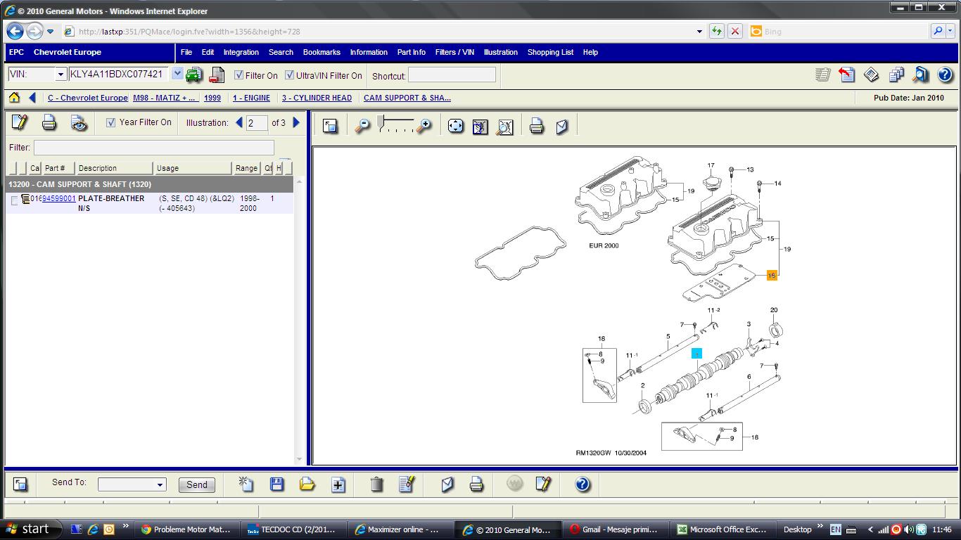

pisboy_sparxx Posted November 11, 2011 Share Posted November 11, 2011 (edited) S-ar putea sa fie cu gazele ,caci cand e montat iese un furtun din el de cauciuc si se duce undeva.Poate ala preia gazele nearse.Probabil la mine e infundat caci ,imi miroseaza a gaze nearse la esapament cand motorul era rece. In programul original il arata ca si piesa demontabila/separata Breather plate (16) se cheama Edited November 11, 2011 by pisboy_sparxx Link to comment
mariusica_ciocan Posted November 11, 2011 Share Posted November 11, 2011 Va salut. Am si eu o problema, pe care probabil ati mai auzit-o si de la alti camarazi. Nu am putut sa rasfoiesc tot topicul despre motor asa ca daca repet, va rog sa ma scuzati Matizul meu nu mai are putere. Nu trage cum ar trebui. Abia daca prind 70-80 km la ora, cu greu. La 35 la ora daca am a 3-a motorul da sa moara, trebuie sa bag trapta inferioara pana pe la 40 km/h. Am fost la tester cu ea, mi-au zis ca este de vina delcoul (eu schimbasem inainte capac delcou, bujii si fise). Am cumparat un delcou din dezmembrari...si face la fel Mecanicul ce mi l-a montat, a zis ca nu este din delcou.Sa merg iar la un tester. Daca imi zic tot delcoul...nici nu le mai dau bani. Ma puteti ajuta va rog? Link to comment
pisboy_sparxx Posted November 11, 2011 Share Posted November 11, 2011 Revin cu informati asupra dacantorului de la capacul culbutori.Am fost si am vazut ca nu se poate desface,e nituit. Link to comment

augustinionut Posted November 12, 2011 Share Posted November 12, 2011 On 11/11/2011 at 5:00 PM, pisboy_sparxx said: Revin cu informati asupra dacantorului de la capacul culbutori.Am fost si am vazut ca nu se poate desface,e nituit. Baga-i in nas un pistol cu aer comprimat, is curios ce iese din el Link to comment
