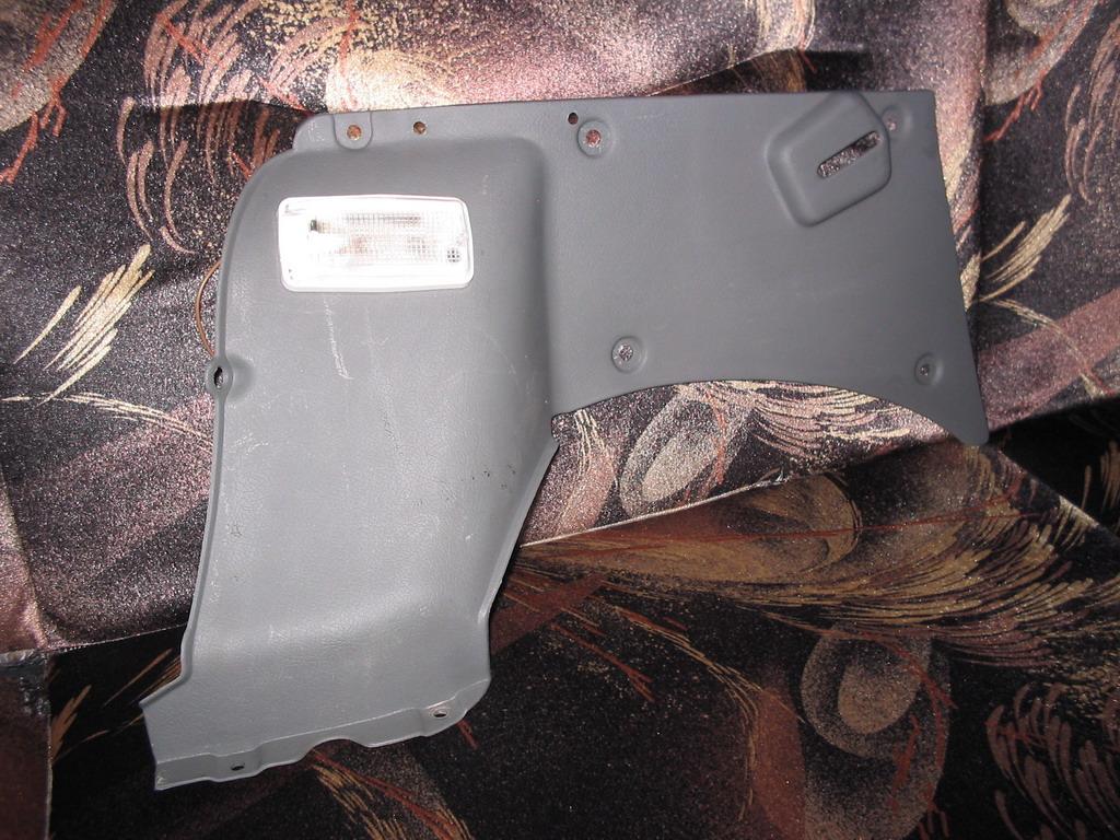

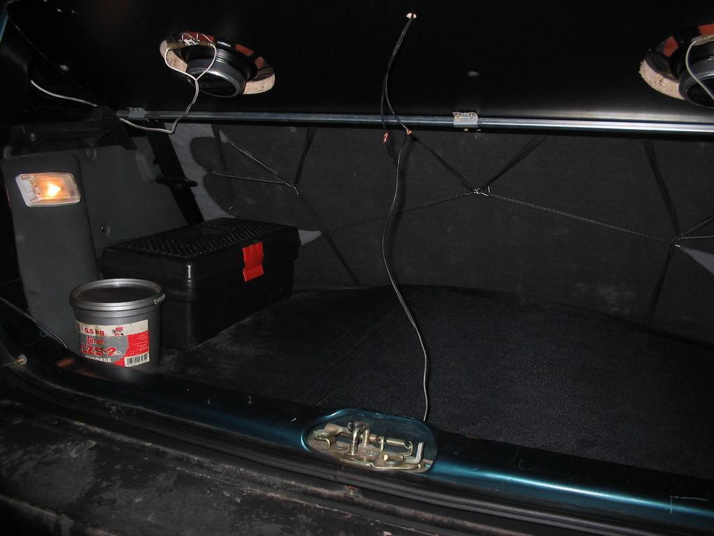

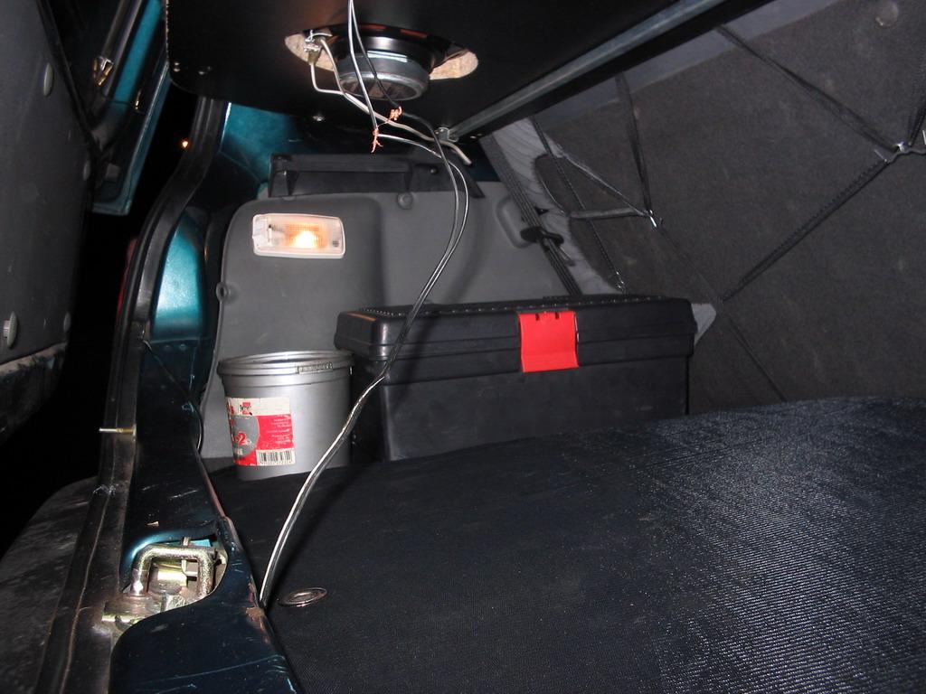

AAdorjan Posted December 28, 2005 Share Posted December 28, 2005 Cumparat plafoniera de dacie cu 6,1 ron. Taiat loc in portpagaj. Montat lampa. Tras firele (ii legat pe pozitie). Si cam atat. Iata ce a iesit : Link to comment
aztec Posted December 28, 2005 Share Posted December 28, 2005 (edited) scuze ca nu am vazut topicul pana acum sa-ti raspund.. plafoniera la fel am si eu, dar am evitat acea parte din cauza alimentarii rezervorului... e putin mai sigur pe partea opusa bravo oricum, este folositoare cate-odata Edited December 28, 2005 by aztec Link to comment
Mircea Posted December 29, 2005 Share Posted December 29, 2005 Da si tu cu niste izolier band pe firele alea negre dezizolate... Link to comment
AAdorjan Posted December 29, 2005 Share Posted December 29, 2005 Inca nu dau cu banda ca vrea sa pun o mufa (tata/mama) in locul firelor. Link to comment
