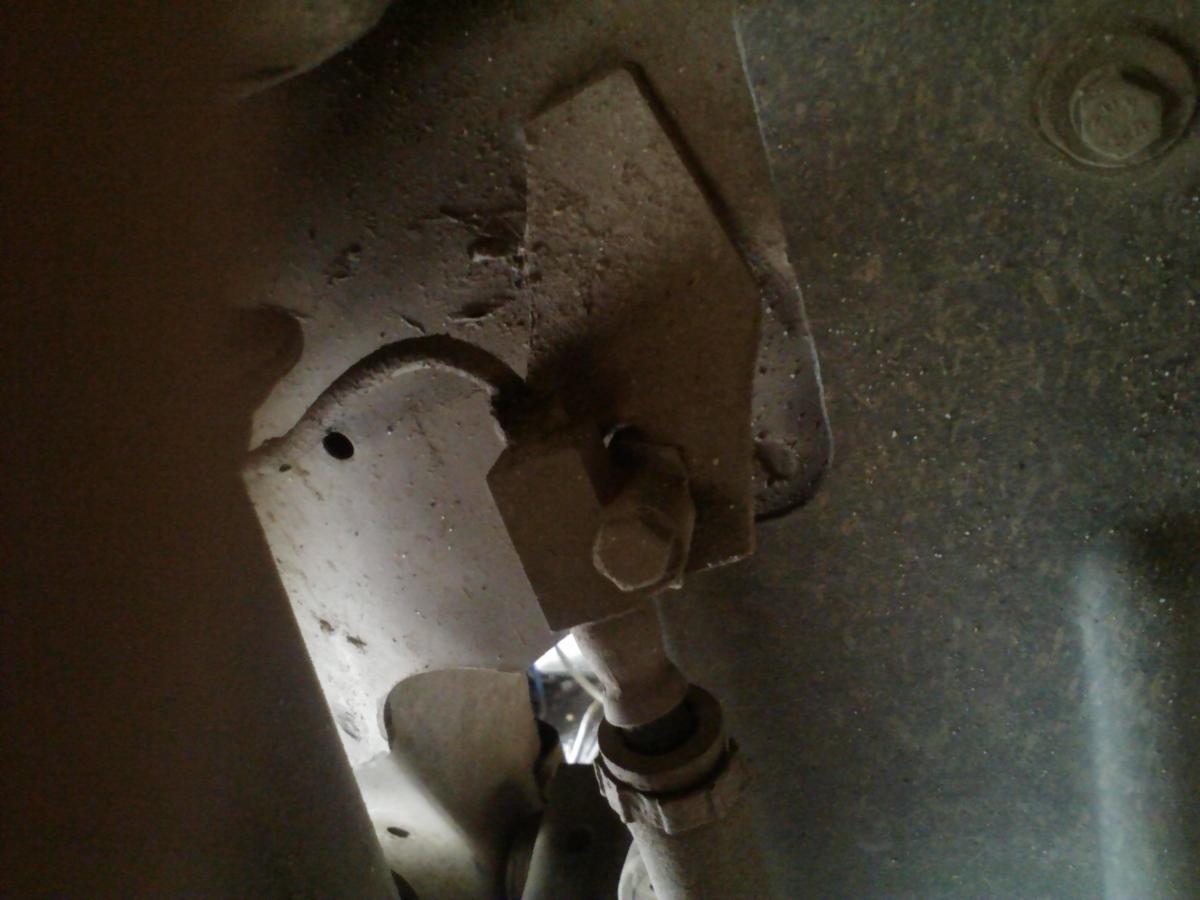

wwwero Posted May 26, 2012 Share Posted May 26, 2012 (edited) salutare caut si eu furtune de frana fata modelul acesta Edited May 26, 2012 by wwwero Link to comment
