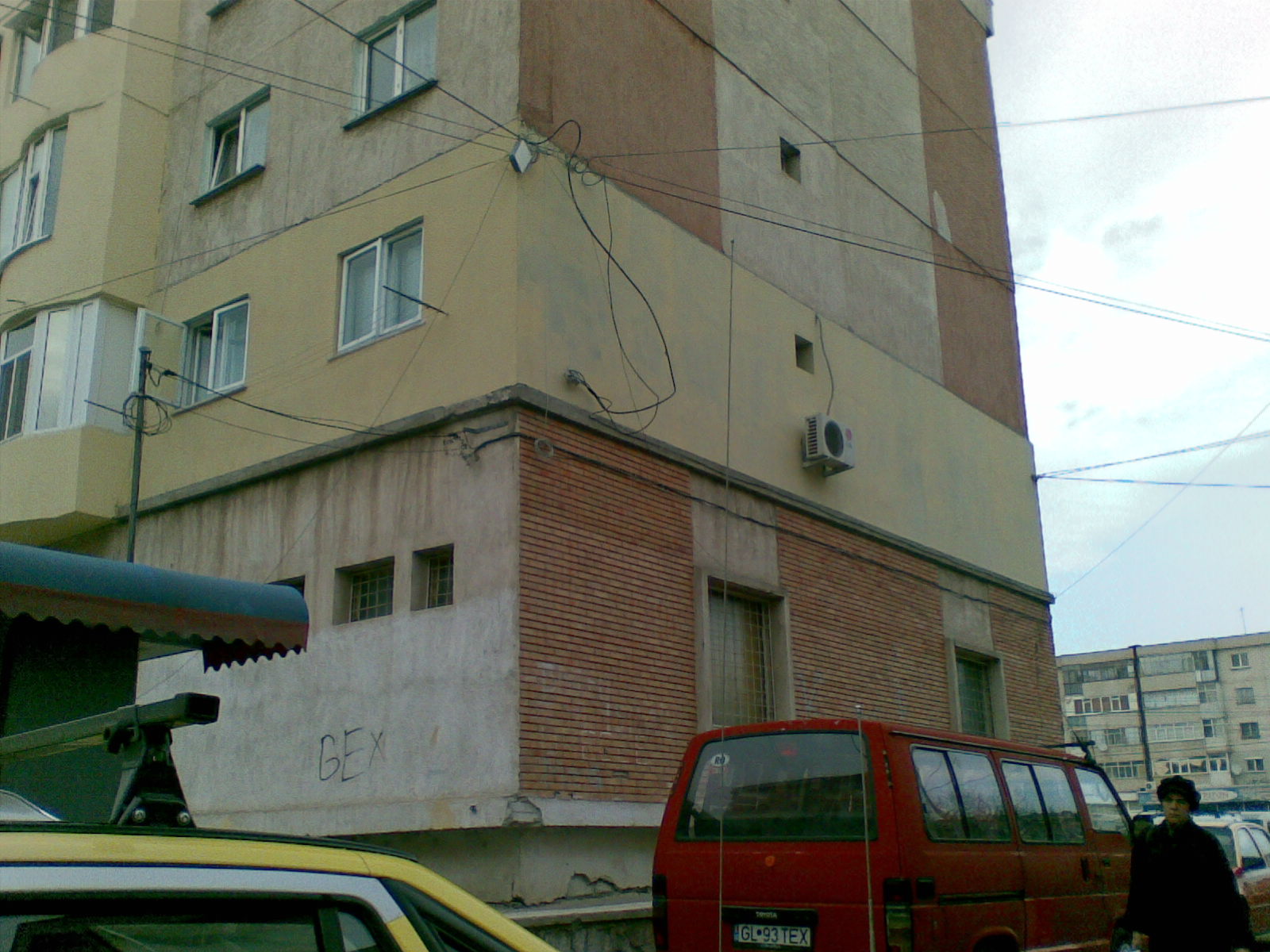

kornelush Posted February 29, 2008 Share Posted February 29, 2008 (edited) Si apropo de desene cred ca iti este suficient acesta sa intelegi ce ziceam(tot ap.de la etajul unu). Edited February 29, 2008 by kornelush Link to comment
