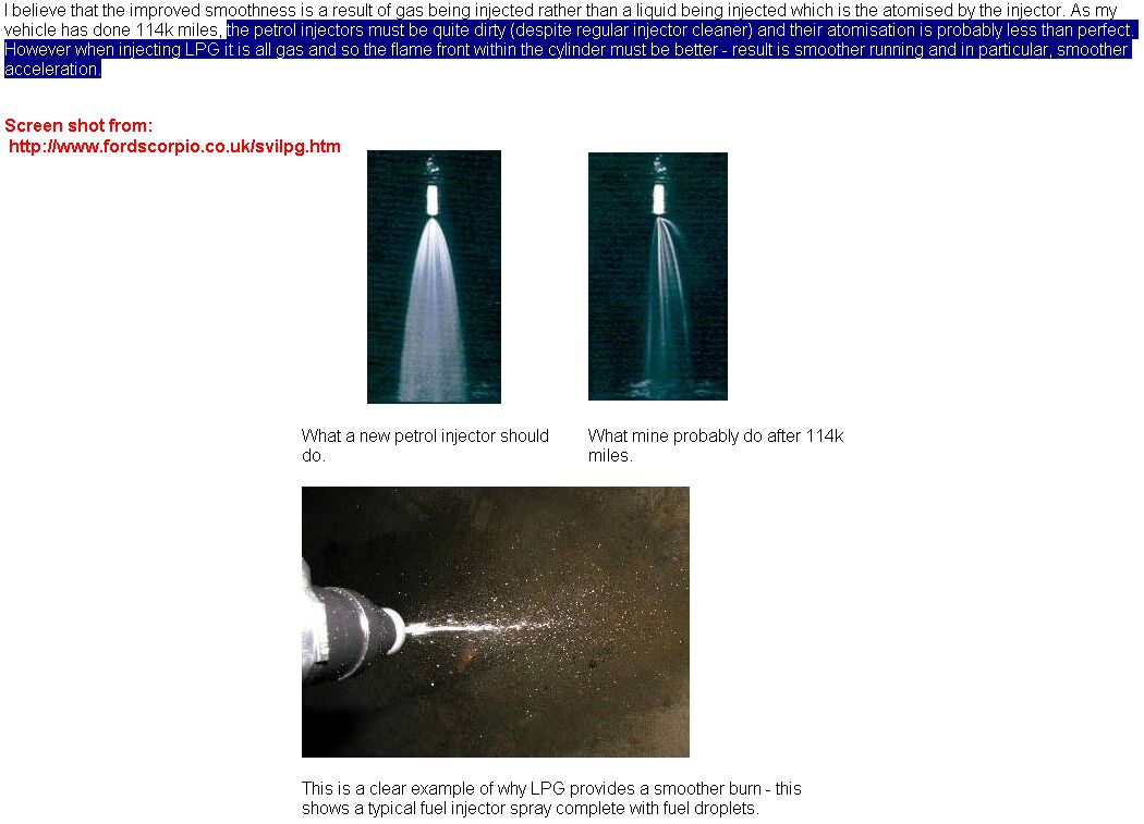

sorin77 Posted September 7, 2006 Share Posted September 7, 2006 Vedeti in poza alaturata exact ce se petrece cu injectoarele uzate si/sau partial infundate. (or click aici) Link to comment
