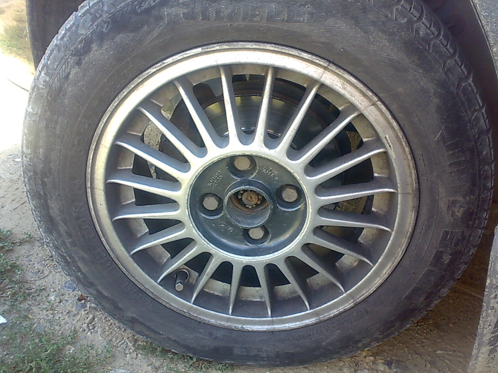

inchains0 Posted June 24, 2008 Share Posted June 24, 2008 ... da, bine ca nu mi-au atins desi am mai mers intr-o seara cu inca 4 pers in masina. Et-ul e de 38 parca, zilele astea pun poze Link to comment

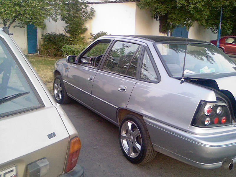

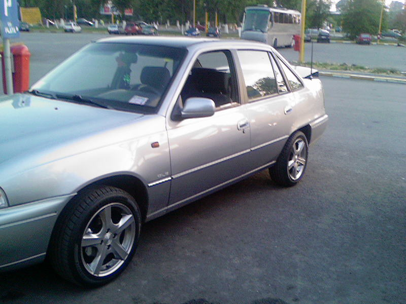

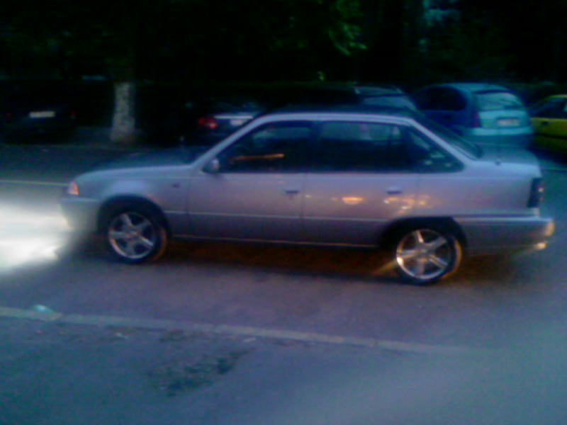

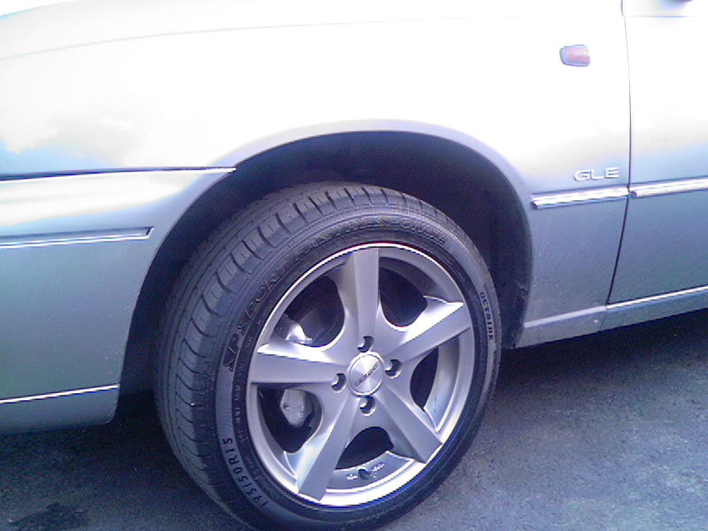

inchains0 Posted June 27, 2008 Share Posted June 27, 2008 (edited) promisesem acum cateva zile niste poze cu jantele mele!!! Edited June 27, 2008 by inchains0 Link to comment
TBird Posted June 30, 2008 Share Posted June 30, 2008 (edited) De ce nu ai facut si tu pozele mai mari ? ... Ca sa vedem si noi detalii etc. Arata super ok imi place Edited June 30, 2008 by TBirdi Link to comment
madkat Posted June 30, 2008 Share Posted June 30, 2008 faine sunt!!!! DAR... dupa excursia de w/e asta pe transfagarasan nu regret ca mi-am pus jante de aliaj pe 13... Link to comment
TBird Posted June 30, 2008 Share Posted June 30, 2008 (edited) Pai de ce ai fi regretat...? Spune-ne si noua niste detalii Edited June 30, 2008 by TBirdi Link to comment

inchains0 Posted July 2, 2008 Share Posted July 2, 2008 promisesem acum cateva zile niste poze cu jantele mele!!! Link to comment
inchains0 Posted July 3, 2008 Share Posted July 3, 2008 am reusit sa maresc pozele, mii de scuze, nu mi-am dat seama de 1 data ca sunt de dimensiune mica Link to comment
madkat Posted July 3, 2008 Share Posted July 3, 2008 nice! pozele tale ma inspira sa aplic oleaca de autocolant pe stalpi Link to comment

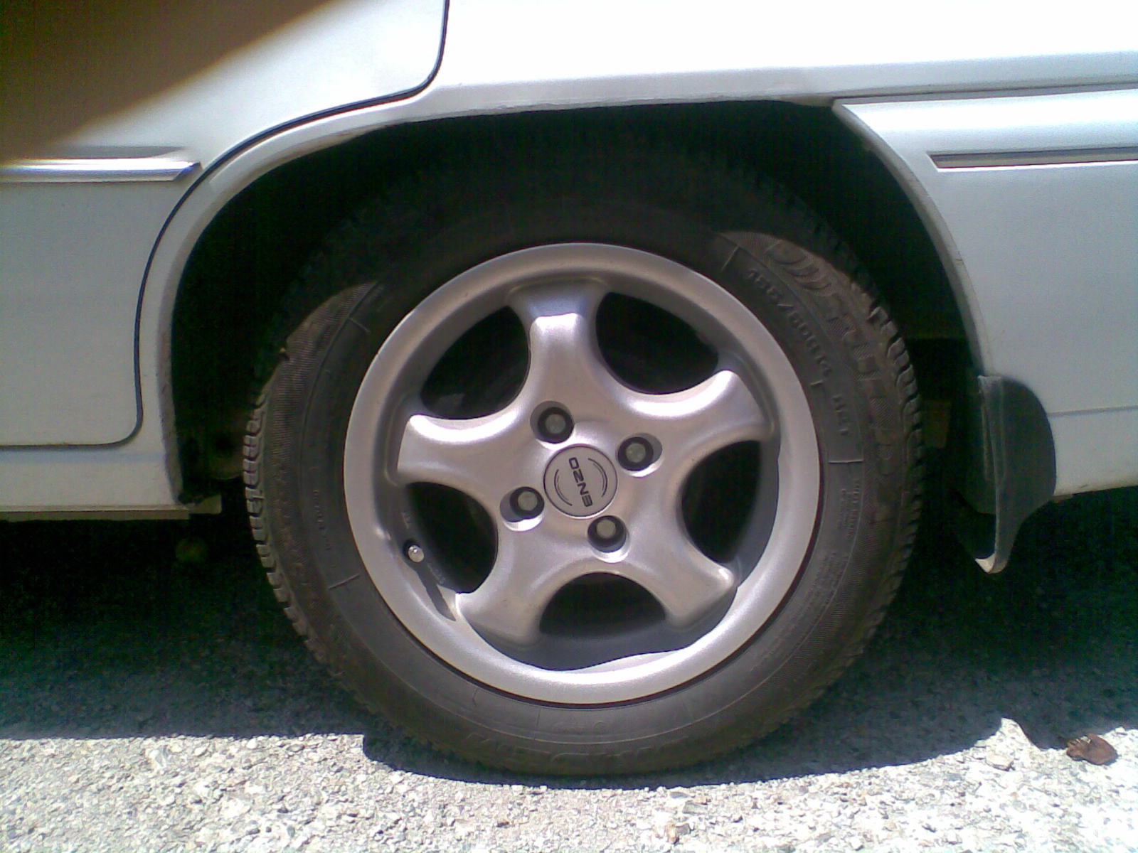

decseiszabi Posted July 6, 2008 Share Posted July 6, 2008 (edited) Am reusit si eu pana laurma cu jentile. Am cumparat jenti ENZO CUP R14, cu anvelope Fulda Linero 185/60 R14. (sunt SH, dar stare ireprosabila, jentile fara nici o zgarietura si anvelope uzate foarte putin - 900 ron). Am incercat si cu bagaje si cu trei pasageri nu imi atinge aripa (cum facea cu jentile de ENZO CUP R15), nici cu cei de la RAR nu am treaba si sunt multumit de ele. Pe ce drumuri avem nu am nevoie de etalon mai mic ca circul mult cu masina si cu acestea nu necesita o atentie mai mare. Ce parere aveti de ele? Edited July 6, 2008 by decseiszabi Link to comment
EM!L Posted July 6, 2008 Share Posted July 6, 2008 Destul de bun pretul, iar jantele sunt elegante, imi plac. Nu-ti ating pt. ca la niciun Cielo jante pe 14 cu cauciucuri 185/60 r14 nu sunt probleme (fara suspensie modificata). Link to comment
TBird Posted July 7, 2008 Share Posted July 7, 2008 (edited) Spre ghinionul meu... imi atinge aripa spate, si eu ma tot laudam ca nu atinge. Venind de la munte ieri cu 3 persoane in spate plus portbagajul ochi ca nu mai aveai loc sa pui o sacosa, mi-a atins de cateva ori cand se balansa masina la denivelari. Solutia zic eu ca trebuie indoita buza de la aripa spate, dar nu stiu metode... in asa fel incat sa nu sara vopseaua. Aveti idee cum sa o indoi ? Ce e drept nu am avut niciodata masina asa full, cam imi era mila de ea asa Edited July 7, 2008 by TBirdi Link to comment

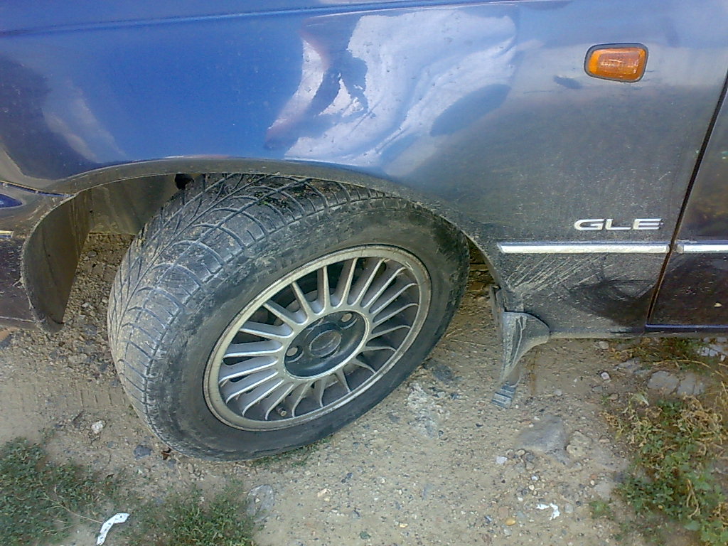

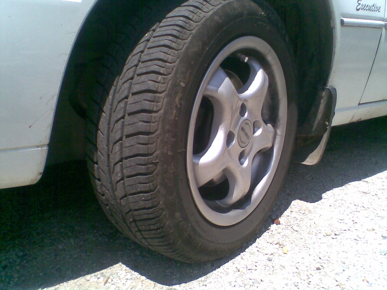

yanny2007 Posted August 4, 2008 Share Posted August 4, 2008 (edited) da... asa se pare ca astea de aliaj sunt prea scoase in afara ... cam astea ar fi jantele care le am ... dak mai are cineva ceva idei ... sau dak vrea cineva un schimb Edited August 4, 2008 by Mircea Sau daca ne scrii in romaneste si intelegi unde e Bursa pe forumul acesta.... Link to comment
