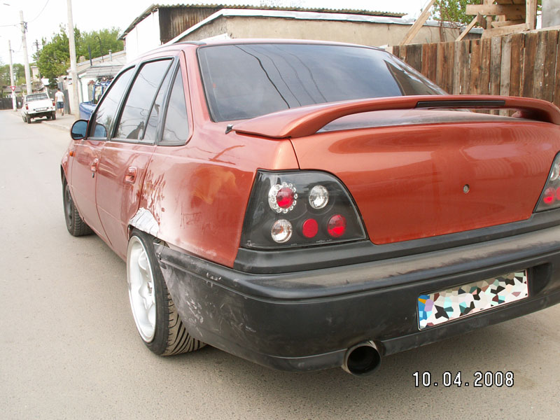

Shift1 Posted May 11, 2015 Share Posted May 11, 2015 Fara evazarea aripilor spate, in niciun caz nu intra 9J. evazare precum in imaginea atasata Link to comment
