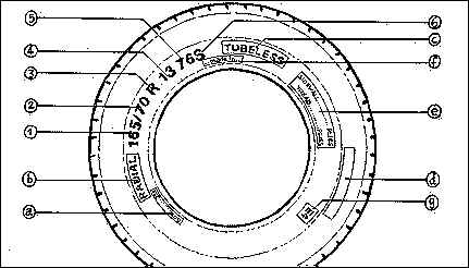

Cumnatu Posted June 12, 2006 Share Posted June 12, 2006 Stiu ca e penibil... Cielo '96 koreea automata. Ce jante am, ce marime ?? Cum aflu ??/ sunt afon Link to comment
sorin77 Posted June 12, 2006 Share Posted June 12, 2006 (edited) Stiu ca e penibil... Cielo '96 koreea automata. Ce jante am, ce marime ?? Cum aflu ??/ sunt afon Ai 2 alternative: 1. Teoretic te uiti in talon si afli ce jante ai ... 2. Practic te uiti pe cauciucurile tale si trebuie sa scrie ceva in genu R1x/165/70 R1x-este dimensiunea jentii, iar x la tine probabil este 3 sau 4 (R13 sau R14), reprezinta raza jentii data in inch (1 inch = 2,54 cm) alte detalii cum citesti un cauciuc - aici (click) Edited June 12, 2006 by sorin77 Link to comment
Tommy Posted June 12, 2006 Share Posted June 12, 2006 (edited) 70 -inaltimea cauciucului de la janta la suprafata de contact (mm), altfel spus inaltimea balonului 70-ul tau e raportul intre inaltime si latime. (a sectiunii) Edited June 12, 2006 by Tommy Link to comment
sorin77 Posted June 12, 2006 Share Posted June 12, 2006 Am sters informatia respectiva, e adevarat ce spui Tommy. Link to comment
