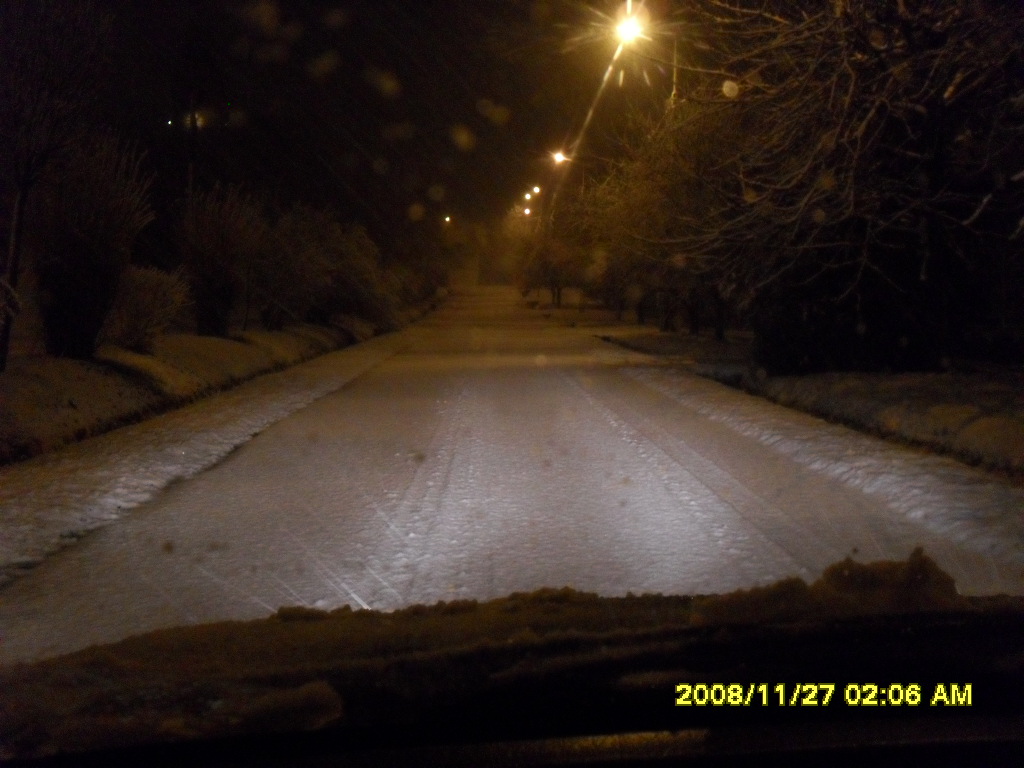

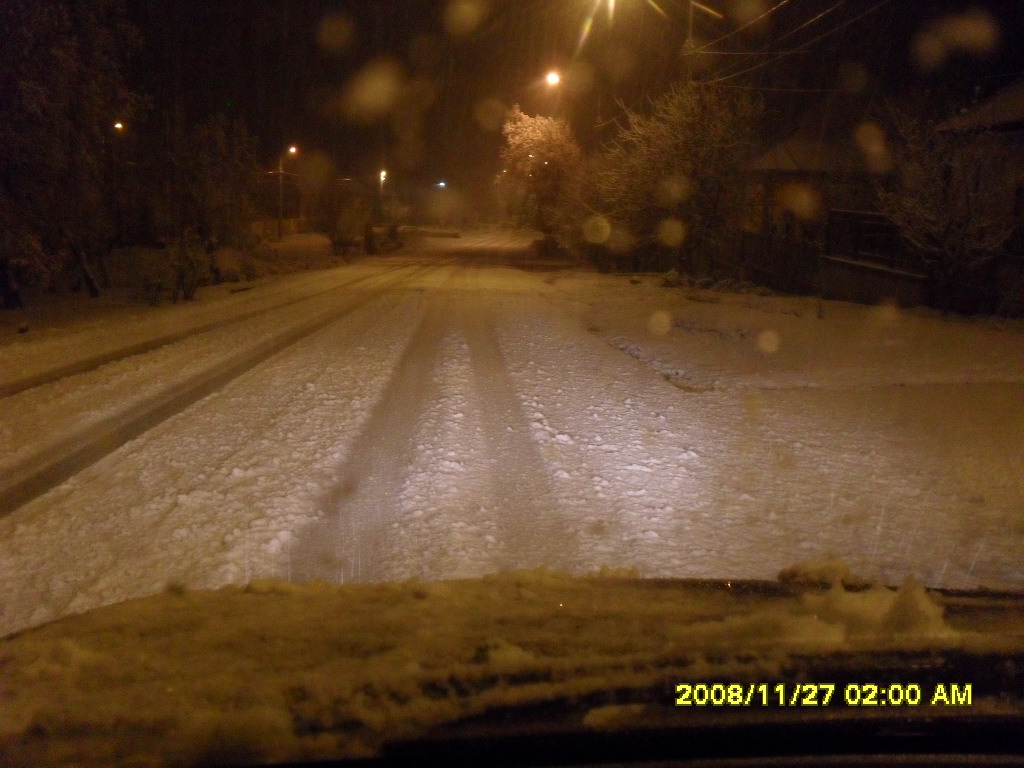

Viktor Posted November 27, 2010 Share Posted November 27, 2010 (edited) Si la mine a venit. Uraaa. Zapada mult asteptata. Si prima cursa prin nameti. La naiba, n-am fost atent la data dar ora e reala. Edited November 27, 2010 by Viktor Link to comment

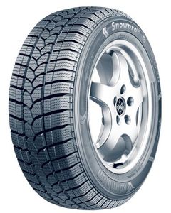

Englishman Posted November 27, 2010 Share Posted November 27, 2010 (edited) Ce fel de caucioace ai, Viktore? PS. Tocmai am inotat si eu prin zapada astazi cu Barumurile mele de iarna, se simt ca pestele in apa. Edited November 27, 2010 by Englishman Link to comment

Viktor Posted November 27, 2010 Share Posted November 27, 2010 (edited) On 11/27/2010 at 4:15 PM, Englishman said: Ce fel de caucioace ai, Viktore? Kormoran Snowpro B2 Atit pe a mea cit si pe una din masinile de servici cu care am mers azinoapte, sint multumit de ele. Cu 60-70 km/h am mers lejer prin nameti, nici iarna trecuta nu mi-au adus probleme. Edited November 27, 2010 by Viktor Link to comment
