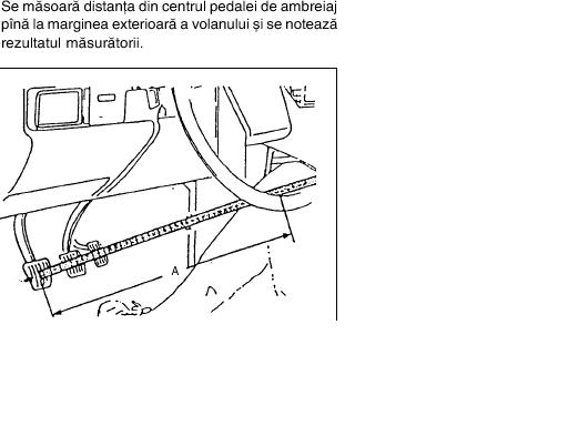

ovi_jer Posted October 15, 2004 Share Posted October 15, 2004 Cursa pedalei de ambreiaj adica diferenta dintre pedala apasata la maxim si pedala libera trebuie sa fie intre 13-13,6 cm.Cursa libera a pedalei trebuie sa fie intre 8-15 mm. Atasez alaturat metoda masurarii cursei pedalei de ambreiaj. Link to comment
Zmeul cel rau Posted October 15, 2004 Author Share Posted October 15, 2004 Asta stiu, dar cursa pedalei lui Viper este mai lunga, nu numai inaltimea punctului unde cupleaza. Link to comment
