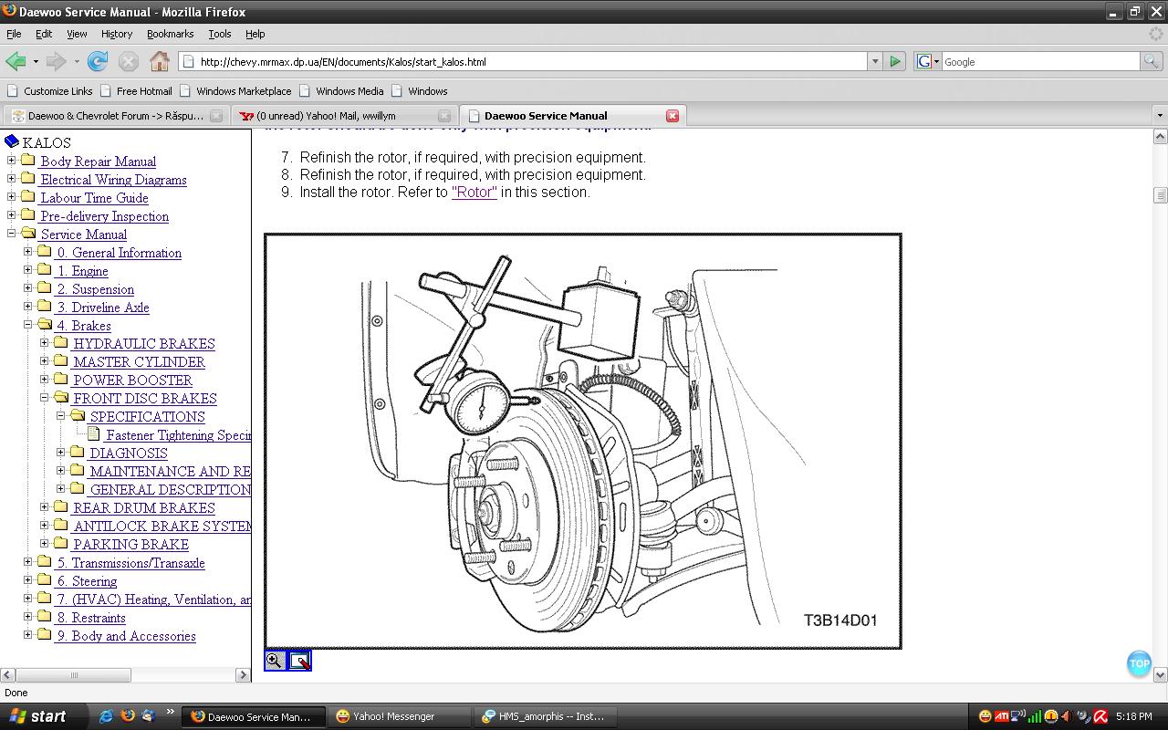

tolin Posted July 15, 2008 Share Posted July 15, 2008 (edited) Aparatul se cheama micrometru, iar metoda de diagnostic este data si in manualul de service, desi este o metoda clasica pentru orice piesa care se roteste, iar aparatul nu lipseste din dotarea oricarui atelier mecanic. Recursul la aceasta metoda simpla l-am facut din postul #67. Edited July 15, 2008 by tolin Link to comment
perfidus Posted July 15, 2008 Share Posted July 15, 2008 Nu e micrometru, e ceas comparator ... ca sa fiu carcotas. Meseriasu' zice ca stie el mai bine, n-are nevoie de scule ca sa-si mai verifice teoria: coreenii nu stiu sa mai faca masini bune dom'le. Link to comment

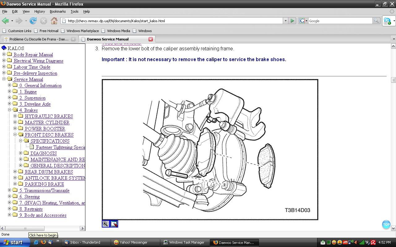

wwillym Posted July 16, 2008 Share Posted July 16, 2008 (edited) Da! Etrierii cu un singur piston isi schimba pozitia...! Si te rog frumos si nu mai rade asa de te tavalesti pe spate, inainte documenteaza-te! Si in alta ordine de idei... da imi place sa mai si gandesc din cand in cand, sper ca acest lucru nu deranjeaza pe toata lumea. Dealtfel, in incheierea postului am precizat, ca s-ar putea sa nu am dreptate, dar de aceea suntem aici pe forum, sa dezbatem unele idei. Citat:The floating design was designed by the car manufacturers essentially to make the caliper less expensive to produce. It successfully applies the physics principle of "for every action caused an opposite and equal reaction happens." With this in mind they eliminated the piston(s) on one side of the caliper. This floating caliper is not solidly mounted, but slides back and forth on bushings or pins. When braking force is applied, the piston push the brake pad on the primary side and the reaction is the rotor being squeezed from the force of the pad primary side allowing the horseshoe shaped caliper to slide on the bushings so the secondary pads is used to squeeze the rotor. The caliper has to be very rigid retain low deflection or the principle will be lost. Cast iron and steel is used because of its' modulus number of 14.5 million and 30 million respectfully. This also increases the "sprung weight" and it retains the heat longer. The big advantage to the full floating design (single piston) is if the rotor has a slight run out (wobble), the floating feature will compensate without creating any instability. The other advantage is the single piston design is easier to bleed. The disadvantages are it heavier, retains heat, requires approximately 100 pounds of pressure more to "slide" the caliper and requires more volume of brake fluid due to the diameter of the piston. Edited July 16, 2008 by wwillym Link to comment
wwillym Posted July 17, 2008 Share Posted July 17, 2008 Etrier culisant cu un singur piston. Din manual: Link to comment
