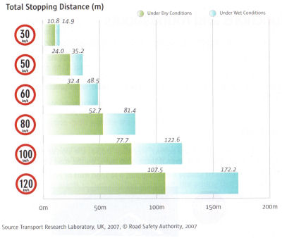

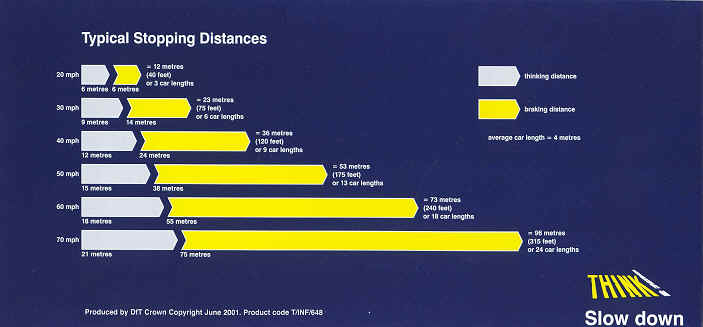

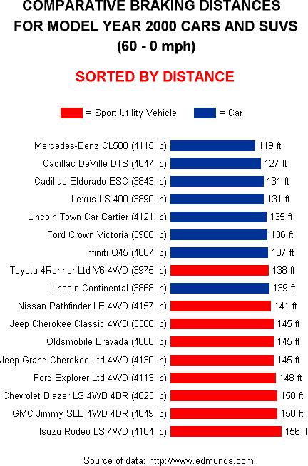

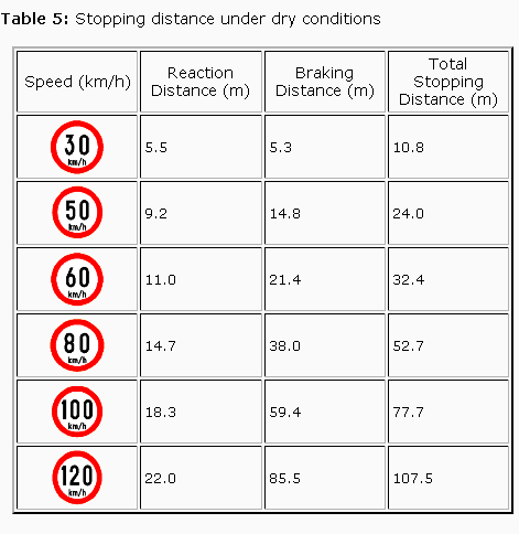

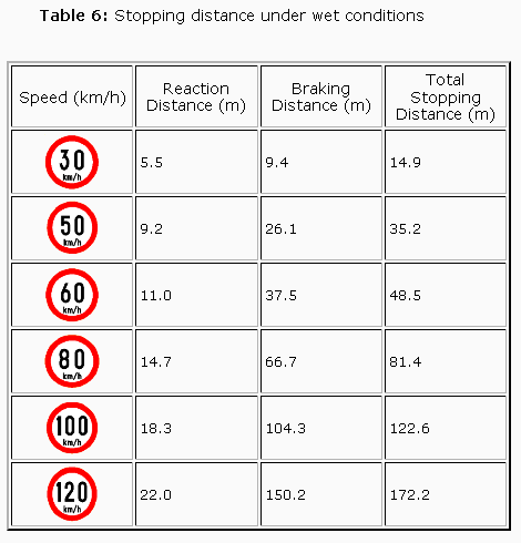

john Posted July 22, 2008 Share Posted July 22, 2008 (edited) In nici un caz nu se deformeaza discurile de la cateva frane serioase de la 100+ km/h Legat de distanta de franare pentru Kalos/Aveo, niste date aproximative: http://www.edmunds.com/insideline/do/Drive...rticleId=117227 It is astonishing to see anything built in the 2007 model year that does not come standard with ABS. The omission of this $400 option from our test car became glaringly obvious when we tested its 60-0-mph braking distance. For perspective, previous testing recorded an average stopping distance of 126 feet for Accent, Fit, Versa and Yaris, each with ABS. Our non-ABS Aveo stopped in a disappointing 150 feet, although we would expect a more competitive result were our test car ABS-equipped. 150 feet = 45,72m 126 feet = 38.40m http://www.motortrend.com/oftheyear/car/11...rolet_aveo.html Braking, 60-0 mph -> 172 ft (52.42m) Si cateva imagini cu distante de franare "generale", pe carosabil uscat / umed. Se observa ca la 120km/h fata de 100km/h, distanta de franare creste cu 50%. Oare cat e la 140+ km/h? Evident sunt multi factori ce pot modifica distantele astea, spre exemplu anvelopele (tip -iarna, vara, all season-, uzura, calitatea), franare la rece/cald, temperatura, etc Edited July 22, 2008 by john Link to comment
EM!L Posted July 22, 2008 Share Posted July 22, 2008 Foarte faine linkurile si pozele postate Se observa ca la 120km/h fata de 100km/h, distanta de franare creste cu 50%. Oare cat e la 140+ km/h?Evident sunt multi factori ce pot modifica distantele astea, spre exemplu anvelopele (tip -iarna, vara, all season-, uzura, calitatea), franare la rece/cald, temperatura, etc ...timpul de reactie al soferului. Numai pana apuca sa duca piciorul deasupra franei (fara a aplica forta asupra acesteia), parcurge o buna parte din distanta la care a facut referire ca fiind cea in care ajunge la 0km/h de la 140 Link to comment
john Posted July 22, 2008 Share Posted July 22, 2008 Timpul de reactie e altceva. Unele grafice au si timpul ala (thinking..) insa acolo sunt masurate distantele de franare in conditii de test (dupa parerea mea atunci sunt eliminati timpii aia) Link to comment
