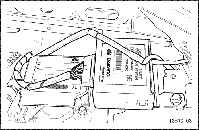

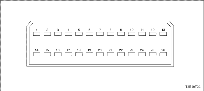

Satori Posted October 21, 2005 Share Posted October 21, 2005 Din manualul de service citire: Remote Keyless Entry and Anti-Theft System The remote keyless entry and anti-theft system can perform the following functions: Remotely lock and unlock the vehicle doors by means of a hand-held, high-frequency transmitter. Sense intrusion into the vehicle. Activate a warning in the event of an intrusion. Help the driver find the vehicle in a parking area. Automatically re-lock the doors if the door or the trunk is not opened within 30 seconds after the vehicle has been unlocked by the remote keyless entry. Communicate serial data to a scan tool to help diagnose system faults. The remote keyless entry and anti-theft system consists of the following components: Keyless entry and anti-theft control module/receiver. Security indicator. Trunk open switch. Trunk tamper switch. Front door tamper switches. Door contact switches. Central door lock relay. Turn signal bulbs. Siren. Hood open switch. Cu ocazia asta, m-am prins si de ce mi-au pus alarma... unde mi-au pus-o . O sa revin cu niste poze edificatoare. Ok, deci: - se identifica asta: - se identifica asta: Iar pinul 1 este pentru goarna. Simplu, nu? Link to comment
kaloman Posted October 21, 2005 Share Posted October 21, 2005 Nu ti-au pus-o sub masca tunelului de transmisie, inaintea schimbatorului de viteza ?? Link to comment
Satori Posted October 21, 2005 Share Posted October 21, 2005 Sa zicem ca pe acolo pe undeva... PS: Doar nu vrei sa iti dau si telecomanda de la alarma 18 LT GRN Key Reminder Switch 19 YEL Security Indicator Cine se plangea ca nu mai vrea piuit daca uita cheile in contact (lucru care mi se pare absurd, dar in fine) poate sa se joace cu pinul 18. 19 sa fie LED-ul din consola centrala? Oare de ce nu l-or fi folosit? Eu as vrea sa il folosesc cand activez alarma (dar sa ramana si ala vechi, de la alarma, pentru ca altfel ma aleg cu o gaura in bord inutila). Link to comment

Satori Posted October 21, 2005 Share Posted October 21, 2005 Acel celebru conector pentru goarna este pinul 1. Noi cercetam existenta firului (deja tras in compartimentul motor) Link to comment
