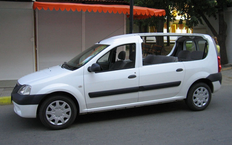

sebian Posted August 20, 2007 Share Posted August 20, 2007 OMFG! http://www.automarket.ro/stiri/logan-mcv-f...garia-5547.html Logan MCV, facut cabrio in Bulgaria Malul bulgaresc al Marii Negre ne pregateste surprize interesante. iata primul Logan MCV tunat in versiune cabrio... Link to comment
Lucian M Posted August 21, 2007 Share Posted August 21, 2007 Arata ca... stiti voi- "cuvant f urat"... Logan versiune "from bad to horrible"... Rog sa remarcati tetierele scaunelor din randurile 2 si 3- din piele de strut... Link to comment
Zmeul cel rau Posted August 21, 2007 Share Posted August 21, 2007 Mie imi place. Raman la parerea ca MCV-ul e cel mai misto Logan. Link to comment
