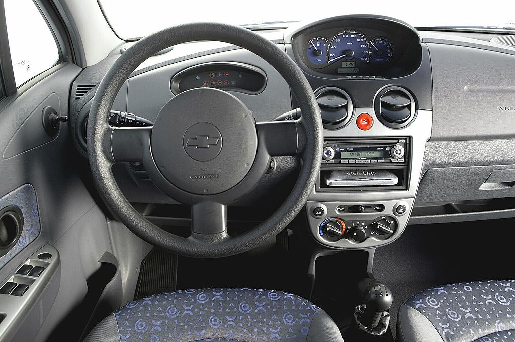

degea Posted May 9, 2007 Share Posted May 9, 2007 Stie cineva se potriveste volanul de la spark pe matiz? Link to comment
uskt2005 Posted May 9, 2007 Share Posted May 9, 2007 Daca ai sa pui acest model iti va fi destul de greu sa urmaresti indicatoarele de la bord "> Link to comment

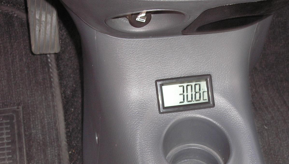

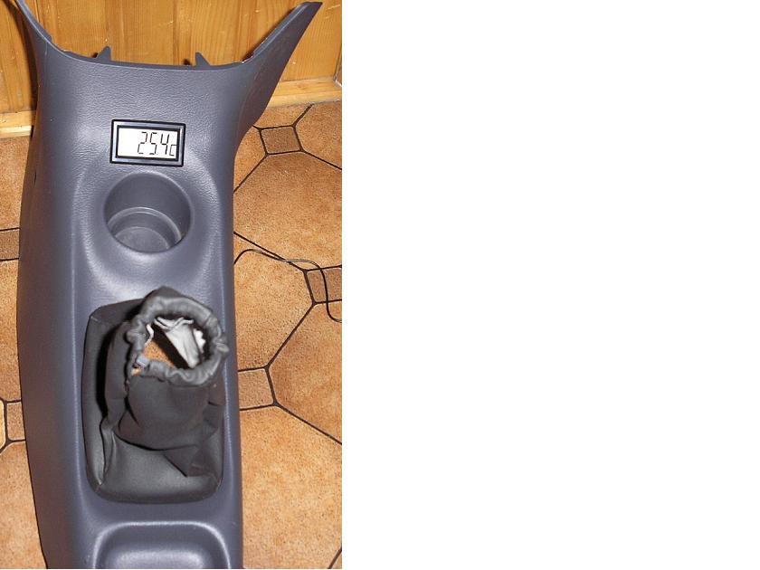

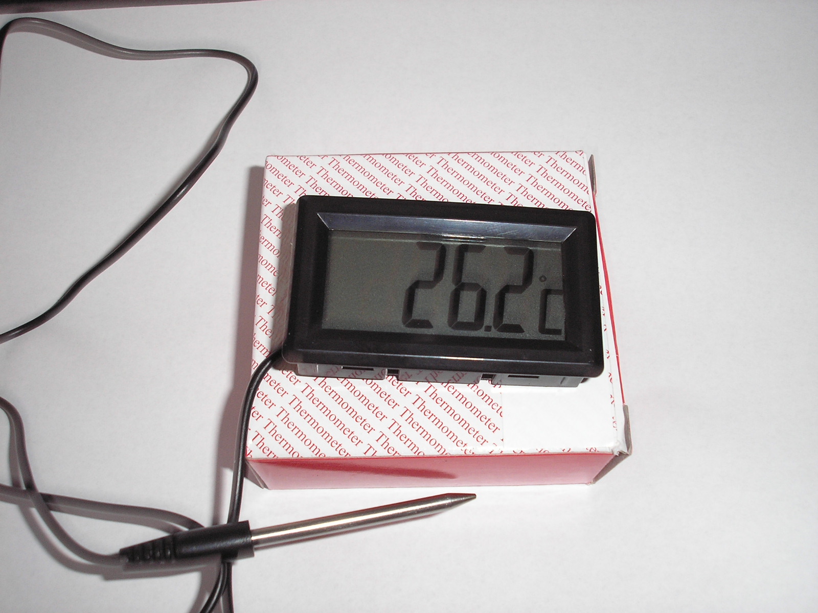

kroko Posted July 31, 2007 Share Posted July 31, 2007 (edited) Azi am montat termometrul digital. http://www.capodimonte.ro/frame_produse.ht...word=TERMOMETRU A costat 31 RON + am asteptat 7 zile deoarece nu aveau pe stoc. Edited July 31, 2007 by kroko Link to comment
closchkutza Posted July 31, 2007 Share Posted July 31, 2007 (edited) Si sonda unde au montat-o? Ai prins termometrul cu ventuza aia pe consola? Are si lumina? Edited July 31, 2007 by closchkutza Link to comment
Abigel Posted July 31, 2007 Share Posted July 31, 2007 (edited) Consola trebuie decupat, se agata in margini intra fortat. Sonda la mine e fixata sub cotiera, vreau sa arate temperatura interioara. Lumina nu are (deocamdata). Edited July 31, 2007 by Abigel Link to comment
closchkutza Posted July 31, 2007 Share Posted July 31, 2007 Ei ziceau ca are nu stiu ce ventuza pe spate. Daca trebuie sa decupez consola, ma las pagubas. Link to comment
Abigel Posted July 31, 2007 Share Posted July 31, 2007 Are si ventuza in spate, dar nu arta nici cum in plus se balangane si iese grosolan. Consola e fixata in trei suruburi si se decupeaza realtiv usor eu am terminat in aprox 25 minute. Link to comment
closchkutza Posted July 31, 2007 Share Posted July 31, 2007 Te cred ca e simplu, dar eu nu ma apuc sub nici o forma sa dau gauri in masina sau orice componenta a acesteia. Link to comment

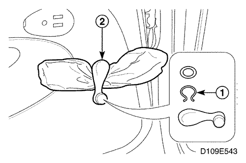

siru Posted October 29, 2007 Share Posted October 29, 2007 (edited) @valiman: buzunarele usilor sunt de Tico, le recunosc. De unde le-ai cumparat/facut rost? Ai buzunar de usa si pe stanga, si pe dreapta? Eu de-abia mi-am pus buzunar de usa de Matiz, dar se fabrica doar pentru usa stanga si nu este simetric ca sa mearga si pe usa dreapta. Duzele de stergator de Tico de unde le-ai cumparat/facut rost? Au cate 2 gauri, nu-i asa? @adrian_r5: Buzunarul se fixeaza pe usa astfel: dai intai jos maneta geamului (prinsa cu o clema care se poate scoate cu o carpa - vezi poza atasata), apoi dai fata usii jos (nu e foarte simplu, e prinsa cu niste chestii de plastic in tabla masinii, trebuie sa bagi un varf de surubelnita invelit in carpa intre fata usii si usa, in dreptul fiecarei cleme de fixare...), apoi dai gauri prin fata usii ca sa pice pe gaurile buzunarului (poti sa iei "amprenta" fetei usii pe o bucata de carton si s-o folosesti ca reper pentru gauri) si prinzi cu suruburi si saibe ce trec prin fata usii si intra in buzunar. Mi-am pus si eu ceas, l-am cumparat de la magazin de piese Daewoo - facut comanda, dat avans, pret 109 RON. Edited October 29, 2007 by siru Link to comment
