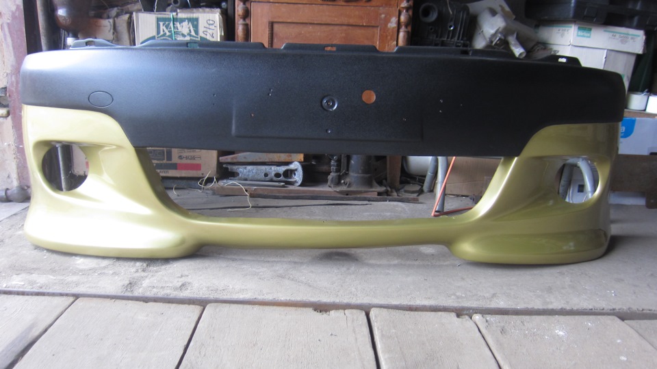

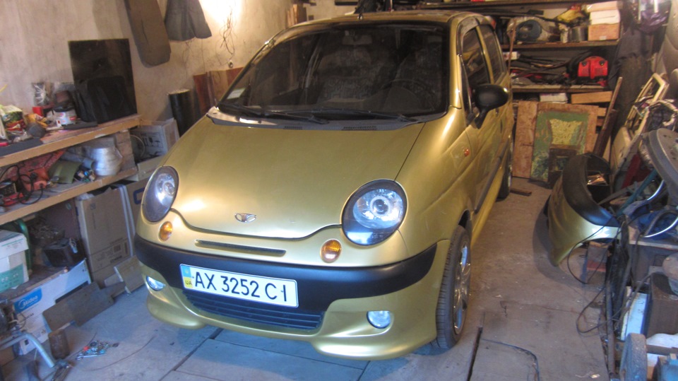

augustinionut Posted May 22, 2014 Share Posted May 22, 2014 (edited) Acum l-am gasit si defilez prin el: http://myautohandmade.blogspot.com.es/ Si de pe alt site : Edited May 22, 2014 by augustinionut Link to comment

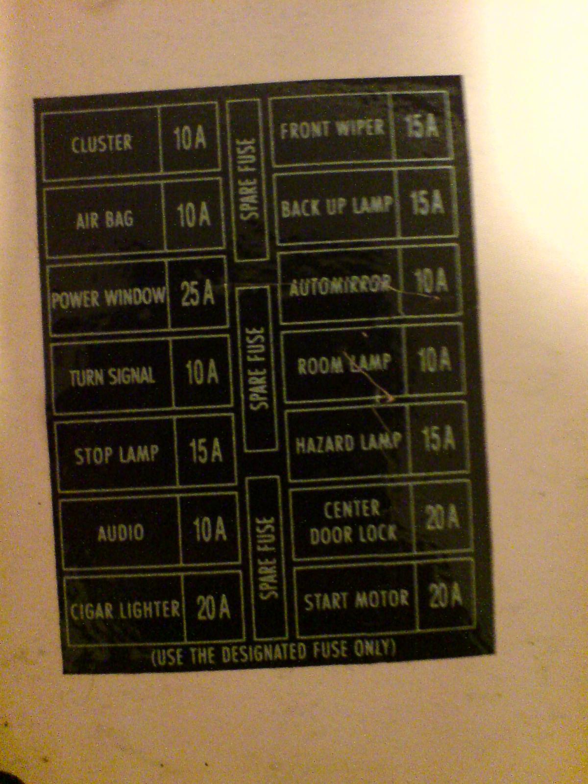

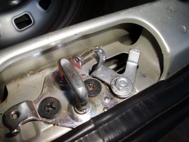

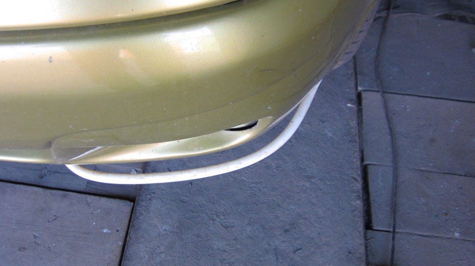

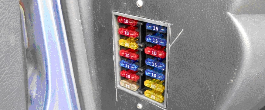

calinjack Posted June 2, 2014 Share Posted June 2, 2014 asta cu sigurantele e buna ideea.eu mi-am rupt capacul de la cutia de sigurante asta iarna can am avut un scurt la bricheta.cum nu se vede acolo sub bord si nestiind sa trag afara capacul,l-am rupt.si asa a ramas.acuma sta in torpedou. Acum l-am gasit si defilez prin el: http://myautohandmade.blogspot.com.es/ Si de pe alt site : ce tre sa vad in poza asta ca nu ma prind Link to comment
augustinionut Posted June 2, 2014 Share Posted June 2, 2014 (edited) Tu nu te prinzi de multe chestii: sistemul de zavor pentru deschiderea cu cablu. Edited June 2, 2014 by augustinionut Link to comment

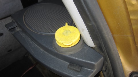

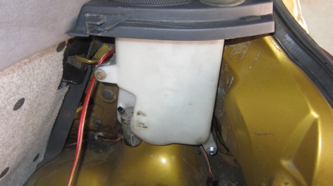

augustinionut Posted June 21, 2014 Share Posted June 21, 2014 Intre timp rusii nu se plictisesc: rezervor spalator spate. Trebuie insa modificata pozitia gatului de umplere, prin taiere si relipire in pozitia adecvata. Bineinteles trebuie "pilit " pe ici pe colo ca sa incapa. Link to comment
bishnitzarul Posted June 21, 2014 Share Posted June 21, 2014 Eu nu inteleg ideea de a mai pune un bidon de lichid...exista deja cel din fata care are locasul pt a doua pompita. La matizul euro 2 furtunul prin habitaclu era tras pana in hayon eu am mai cumparat 2m de furtun ca sa trag din a 2-a pompa pana la pedalier. Link to comment
augustinionut Posted June 21, 2014 Share Posted June 21, 2014 (edited) Poate are vodca, pentru pasagerii spate Poate stropeste cu benzina masinile cevor sa depaseasca ... cine stie... oricum era prea multa liniste pe forum EDIT: a meu nu are nici un furtun in plus. Edited June 21, 2014 by augustinionut Link to comment

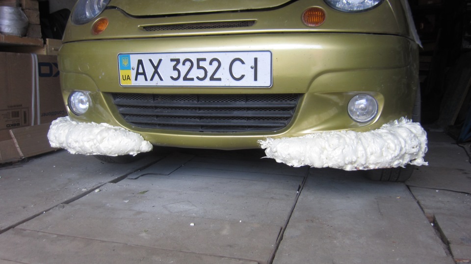

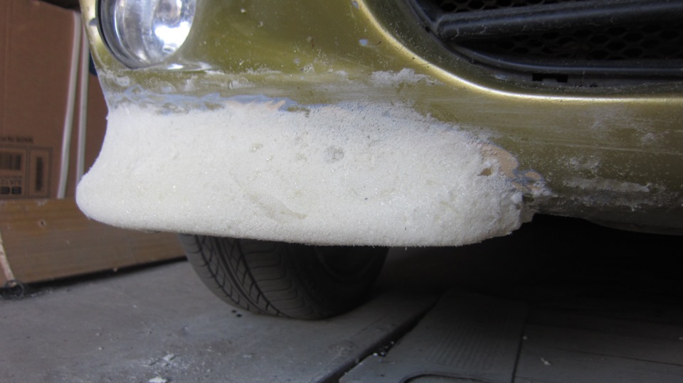

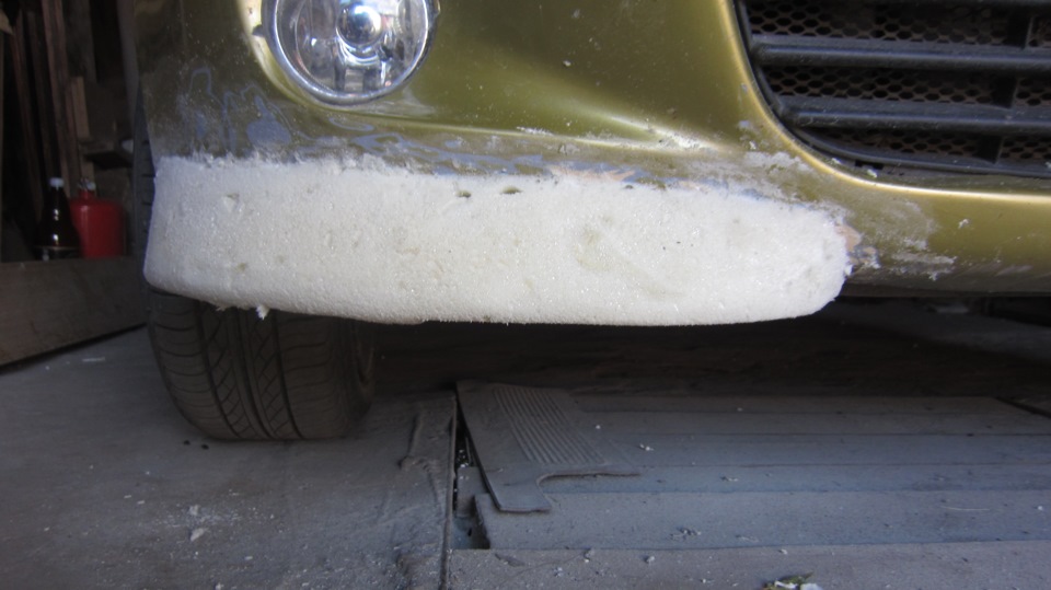

calinjack Posted June 29, 2014 Share Posted June 29, 2014 adica?io vad putina spuma... Link to comment

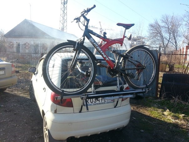

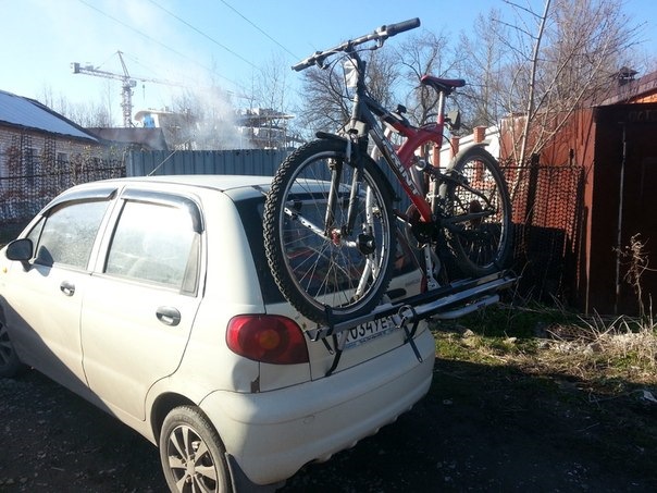

augustinionut Posted July 4, 2014 Share Posted July 4, 2014 Thule ClipOn 9105 + matiz. Link to comment
augustinionut Posted July 13, 2014 Share Posted July 13, 2014 (edited) Thule ClipOn 9105 + matiz. Cred ca hayonul ar trebui sa reziste si la o roata de rezerva . Edited July 13, 2014 by augustinionut Link to comment
