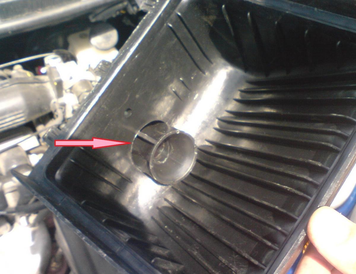

bishnitzarul Posted September 27, 2012 Share Posted September 27, 2012 (edited) ce este incercuit este rezonatorul...unde sunt cele 2 sageti se afla restrictorul( ca sa il dai jos trebuie sa ridici capacul de la cutia filtrului de aer ) Edited September 27, 2012 by bishnitzarul Link to comment

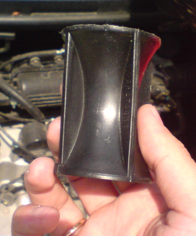

vrazvanc Posted September 9, 2014 Share Posted September 9, 2014 Scuzati-mi ignoranta, mereu m-am intrebat la ce foloseste acel tub, la ce e bun? Am dat click pe link, dar nu am inteles, decat...ca...daca e scos, mai ies niste manji frumosi. Si la Euro II, de ce se putea regla? La Euro III pare fix, nu am reusit sa-l misc. Link to comment

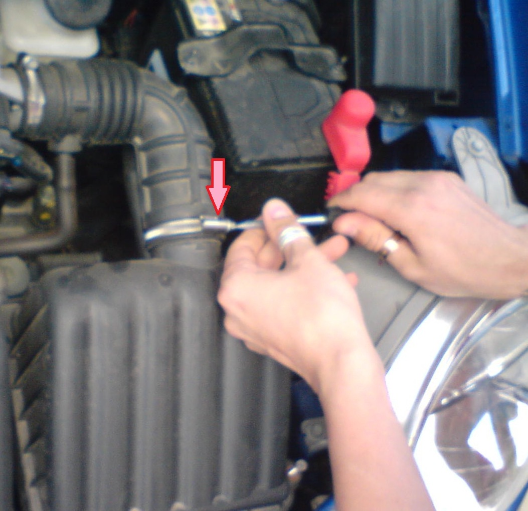

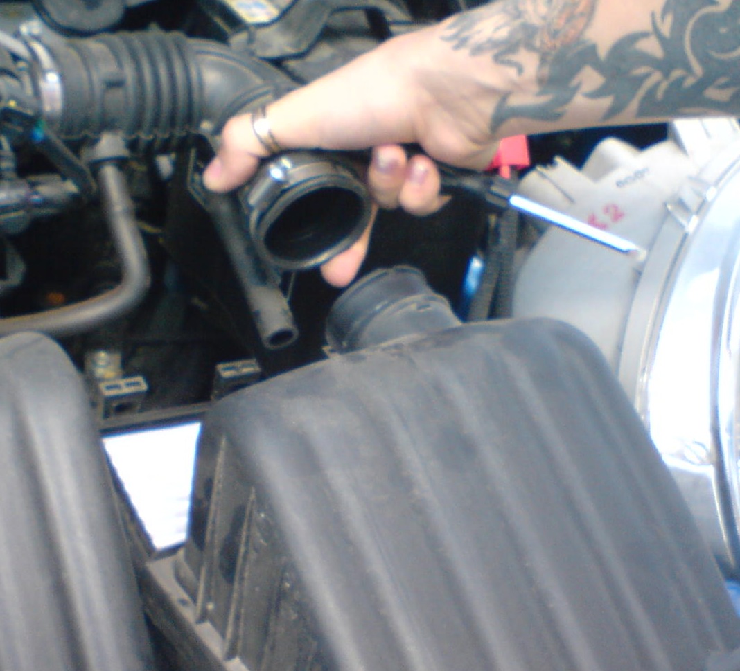

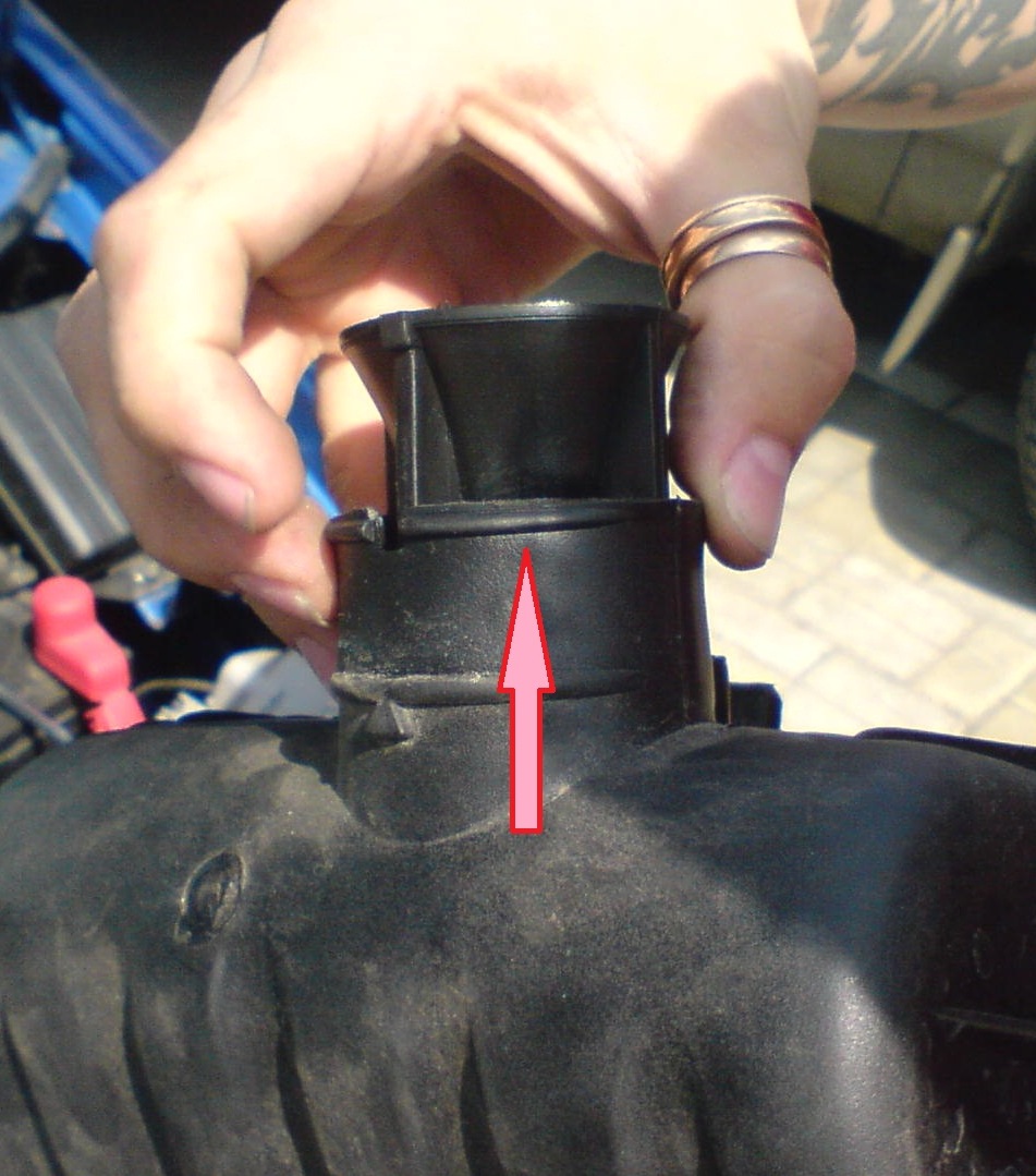

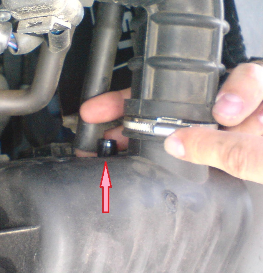

trebor271074 Posted September 10, 2014 Share Posted September 10, 2014 Si al meu tot euro III e... cum poate fi scos acest restrictor? Din foto nu rezulta si cum engleza mea e la pamant... Ma poate ajuta cineva si sa imi explice, asa, ca la prosti... cum se face? Link to comment
augustinionut Posted September 10, 2014 Share Posted September 10, 2014 (edited) Valeu... PS pentru Amundei : http://photo.qip.ru/users/1667132/3780251/ Edited September 10, 2014 by augustinionut Link to comment
trebor271074 Posted September 11, 2014 Share Posted September 11, 2014 Mii de multumiri... acum am priceput! ma intreb si eu... ce au avut in cap proiectantii cand au pus asa ceva pe masina, si ce rol i-au prevazut? Are un rol real si folositor? Link to comment
vrazvanc Posted September 11, 2014 Share Posted September 11, 2014 Acum am priceput si eu, faceam confuzie, credeam ca prima "cutie" e restrictor, dar acum e logic, teava asta are diametru mai mic, restrictioneaza fluxul de aer=restrictor ) Nu m-a pasionat subiectul, dar de cand am avut primul Matiz mi s-a parut ca nu prea respira in voie. Link to comment
