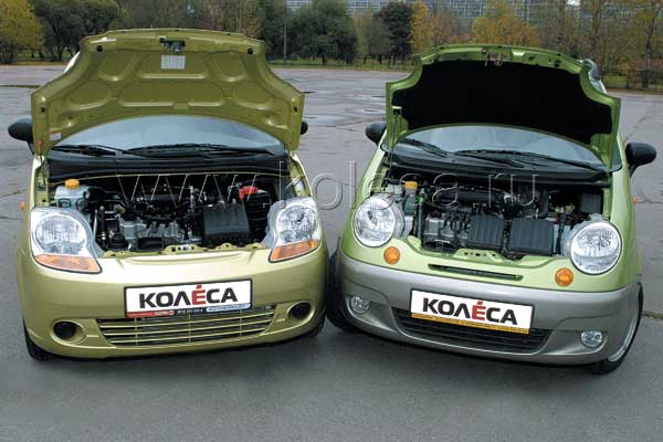

florinbad Posted May 11, 2006 Share Posted May 11, 2006 Oricât de mult m-am chiorât la fotografie, n-am observat bucata aia de cauciuc lipita de capota (bucata pe care o am si eu, ca si majoritatea posesorilor de Matiz) ... Link to comment
SORAN Posted May 11, 2006 Share Posted May 11, 2006 La matizu din dr din poza e si rezonatoru mai mare si capota are "blana"...o fi mai silentios? Link to comment
dAKuL_maniaK Posted May 11, 2006 Share Posted May 11, 2006 (edited) fftopic: Cred ca ala din stanga e Spark si ala din dreapta Matiz II Edited May 11, 2006 by dAKuL_maniaK Link to comment
