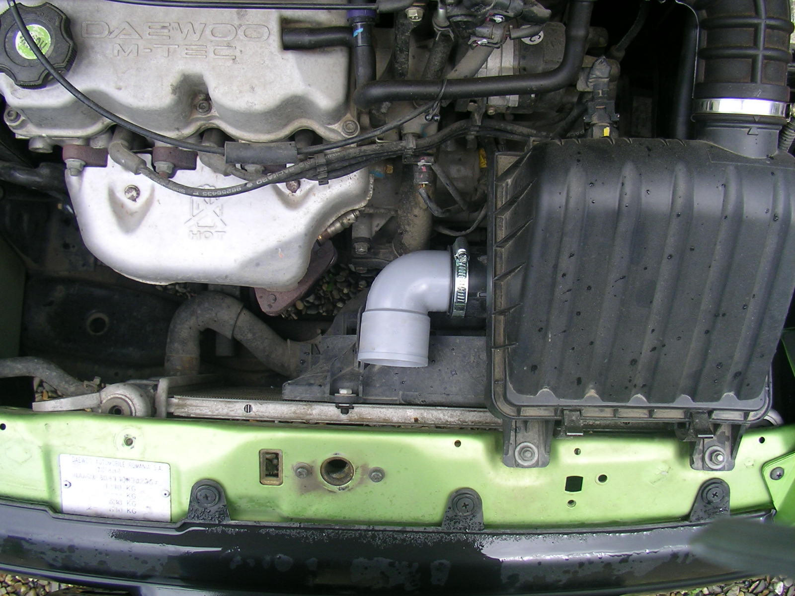

ciprianita Posted June 5, 2006 Share Posted June 5, 2006 (edited) Am renuntat la restrictor si rezonator, sincer nu am ce comenta totul e OK! si surpriza teava de esapament este alba sau mai bine curata ( nu stiu de cand n-am mai vazut-o asa) A si o poza! Edited June 6, 2006 by NFS Link to comment
Mircea Posted June 5, 2006 Share Posted June 5, 2006 E un cot de scurgere la 90 de grade din polipropilena, de 1 tol. Il gasesti la magazinele de sanitare Link to comment
