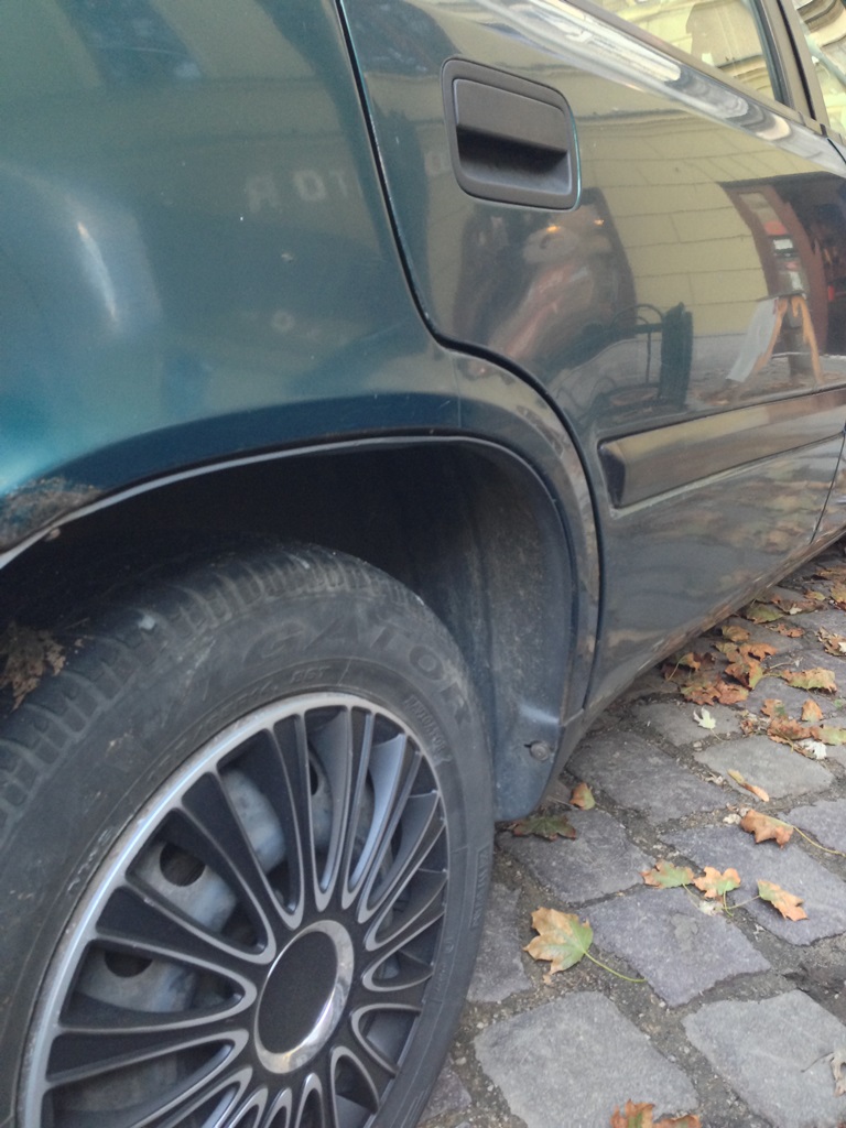

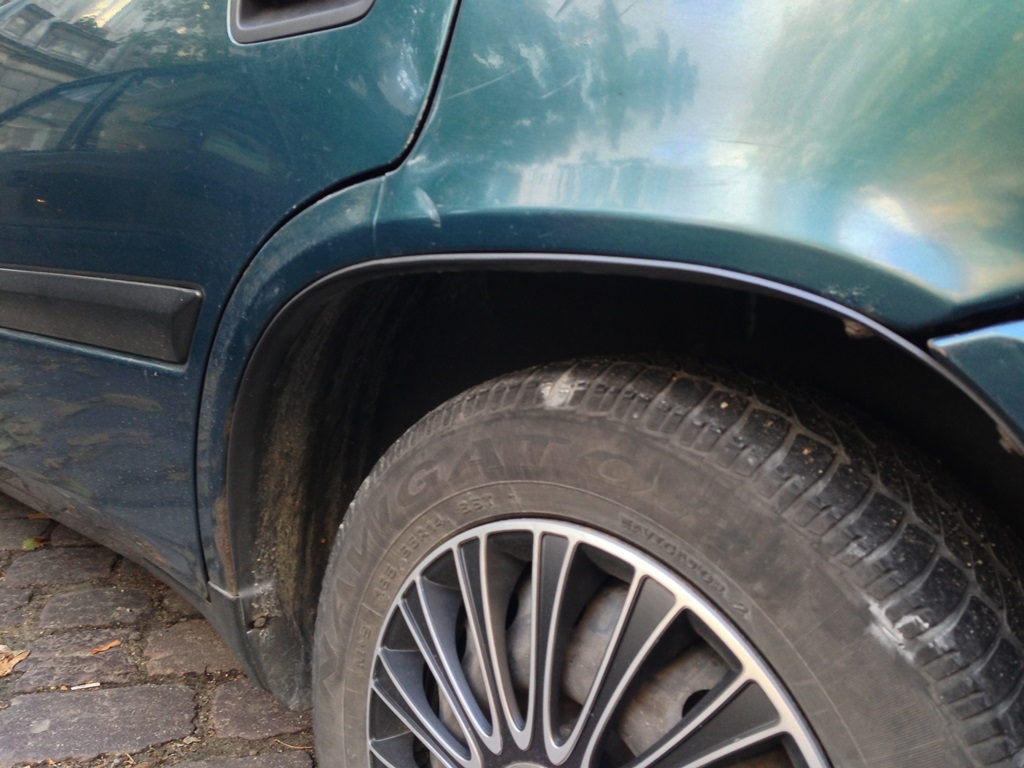

mirceajo Posted September 9, 2013 Share Posted September 9, 2013 (edited) ia de aici Dl DjDark, aparatori de noroi spate, gasite pe un espero in Polonia: Edited September 9, 2013 by mirceajo Link to comment
Dj_Dark Posted September 9, 2013 Author Share Posted September 9, 2013 Degeaba bre, tot e ruginita. Vine din interior si gaura aia de la surub mai mult strica. Link to comment
