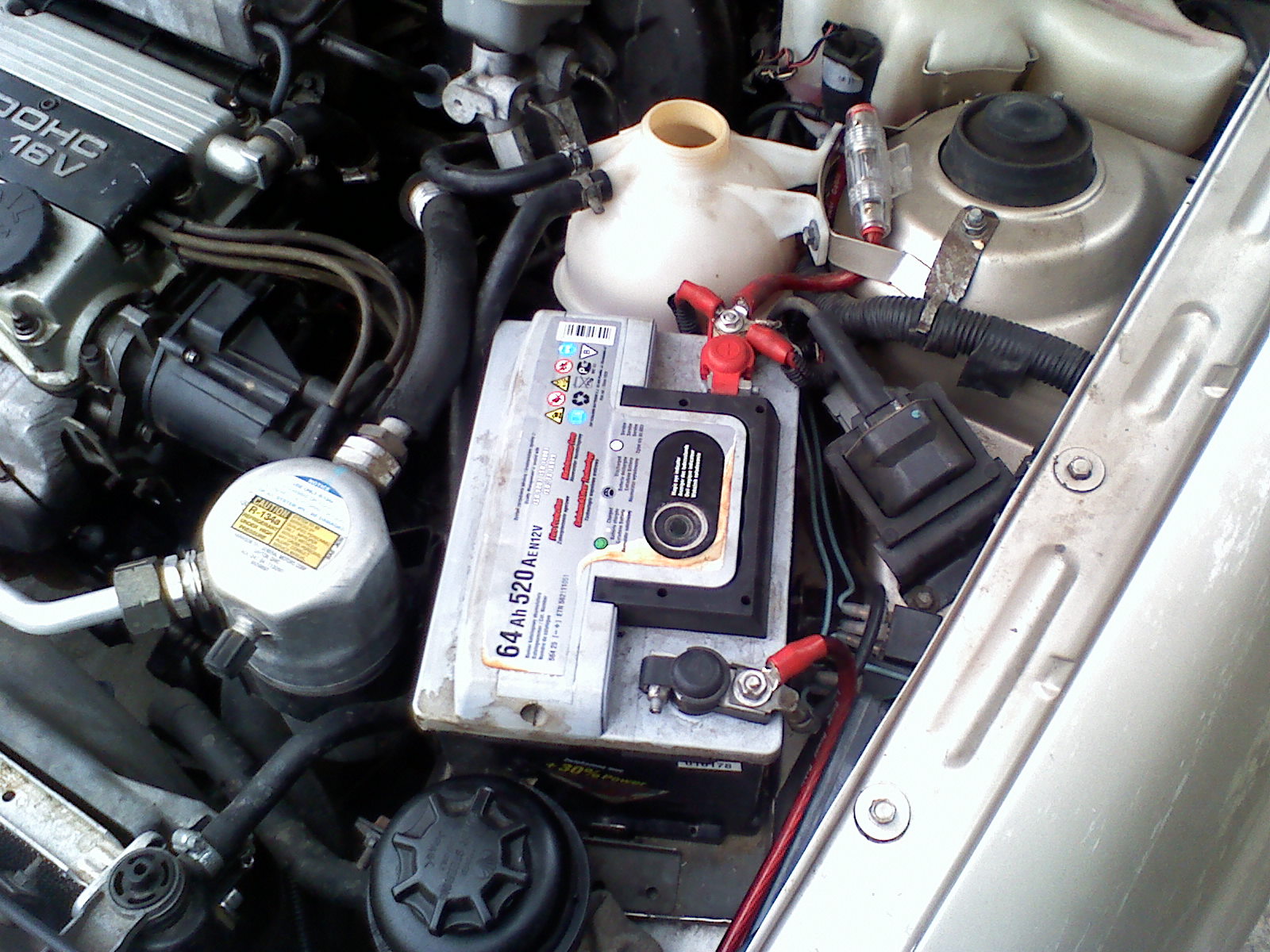

Dj_Dark Posted October 29, 2009 Author Share Posted October 29, 2009 (edited) Merci de sfat. Momentan voi astepta sa vad daca macar am rezolvat problema sau mi-am murdarit instalatia degeaba, dupa mai vedem. Cam asa arata conexiunile mele la baterie mai nou. @velican. Da domnu' da' la pisici se pare ca n-am noroc . Edited October 29, 2009 by Dj_Dark Link to comment
argon Posted October 29, 2009 Share Posted October 29, 2009 capacul de la vasul de expasiune unde-i? Link to comment
Dj_Dark Posted October 29, 2009 Author Share Posted October 29, 2009 Probabil pe langa pe undeva. Link to comment
argon Posted October 29, 2009 Share Posted October 29, 2009 nu ar fi mai bine sa stea insurubat la locul lui? Link to comment
Dj_Dark Posted October 29, 2009 Author Share Posted October 29, 2009 (edited) Eram inca in etapa de intretinere. Ma pregateam sa schimb agentul de racire din instalatie. Poza e facuta imediat dupa ce am schimbat borna de +. Acum capacul cu pricina e la locul lui. Edited October 29, 2009 by Dj_Dark Link to comment
argon Posted October 29, 2009 Share Posted October 29, 2009 (edited) Scuze, credeam ca asa umbli, ma miram eu ca esti asa nepasator cu masina, dar am vazut cu ochii mei multi pe care nu-i interesa ca nu mai este capacul ala acolo, si mergeau asa fara greturi...o perioada macar Edited October 29, 2009 by argon Link to comment
Dj_Dark Posted October 30, 2009 Author Share Posted October 30, 2009 Nu prea merge fara el. Pe langa faptul ca din lipsa presiunii nu ai caldura iarna cum trebuie, vara daca te dai putin la ea la primul semafor ai jumatate de apa jos. Aia care merg fara el au fisuri in instalatie si fara presiune nu mai curge, am mers si eu o data pana la magazin asa. Link to comment

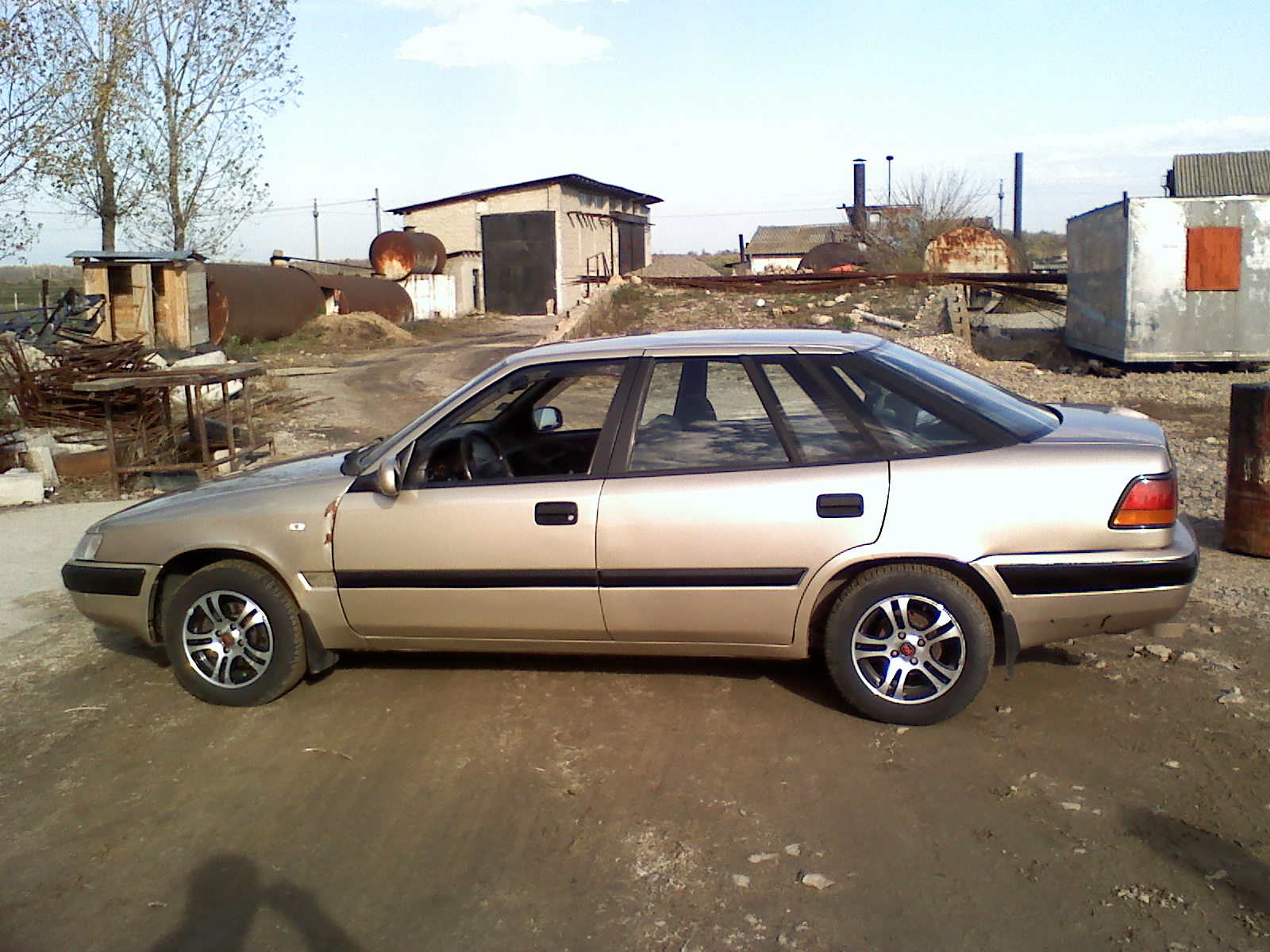

Dj_Dark Posted November 9, 2009 Author Share Posted November 9, 2009 Si am trecut si eu la iarna. Mi-am montat rotile si i-am dat probabil ultima spalare pana in primavara . Uleiul se mentine bine (a scazut de la maxim la aproape jumatate in 4000 km), apa la fel, a scazut maxim 5mm insa e greu sa-mi dau seama de nivel exact din cauza variatiilor la cald si rece. Instalatia nu o mai spal sezonul asta, caldura baga. Mi-am schimbat joi lampa dreapta spate cu una de la dezmembrari (foarte buna de altfel, ma asteptam sa fie zgariata) si azi mi s-a ars becul pe frana din ea problema rezolvata rapid de dimineata la primul peco. In rest, gata cosmetizarea pe anul acesta Si o poza PS. Jantele ma gandesc sa le pun la vanzare, inca nu am pus anunt la bursa inca, daca le vrea vre-un cunoscut intre timp discutam. Link to comment
Costi VLN Posted November 9, 2009 Share Posted November 9, 2009 Ce frumoasa arata asa curata.Mai putin aripa fata care trebe schimbata.Da stiu iti sta pa cap. Tu vb serios ca pana la primavara nu o mai speli? Link to comment
Dj_Dark Posted November 10, 2009 Author Share Posted November 10, 2009 (edited) Pai, spalata atrage atentia si cu asta apar si zgarieturile. Lume invidioasa dom'le Daca se mentine vremea frumoasa poate, daca incep ploile si ninsorile o mai spal cand nu mai vad prin geamuri . PS. Aripa, mai am putina rugina la oala dreapta spate, spoiler spate (cojit de bine ce a fost pregatit) si niste mici retusuri la vara. Mai trebuie de asemenea sa vopsesc portbagajul (interior/exterior) si o bucata din lonjeronul stanga (de la impact a sarit vopseaua pe o portiune). Edited November 10, 2009 by Dj_Dark Link to comment
