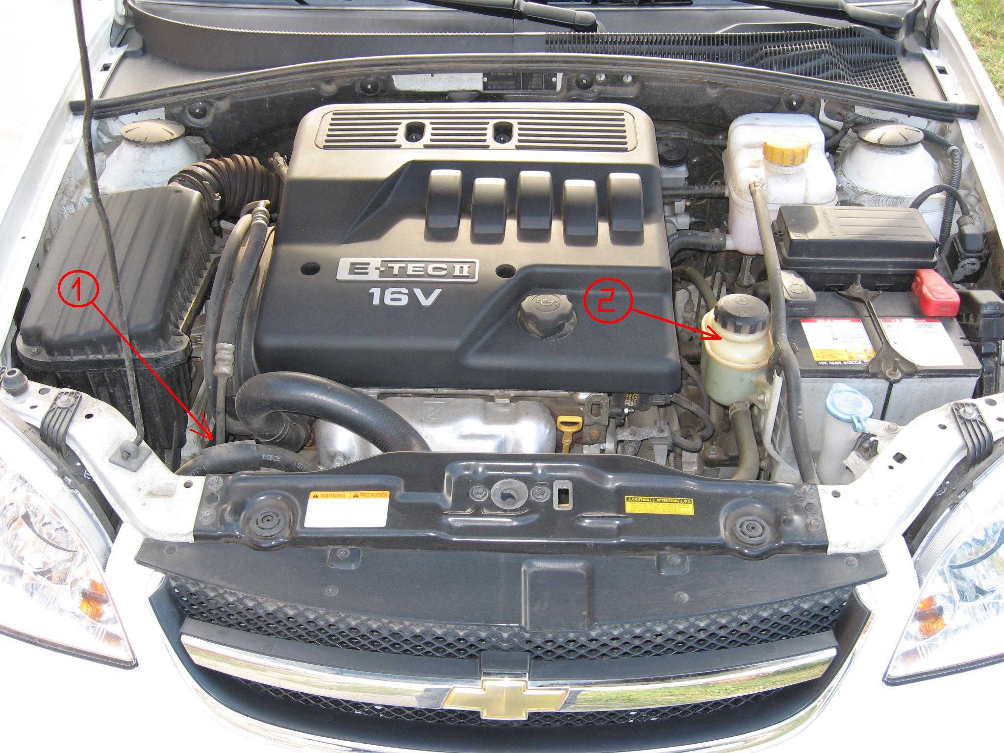

perfidus Posted September 7, 2007 Share Posted September 7, 2007 Un desen o sa fie mai de folos... )"> Pe sageata 1 se vede cureaua puchinoasa, iar la 2 e vasul cu lichidul de servo, cu nivelul vad ca stai foarte bine. Link to comment
Elfu Posted September 7, 2007 Author Share Posted September 7, 2007 Merci @perfidus si Mircea. Spal duminica. Link to comment
