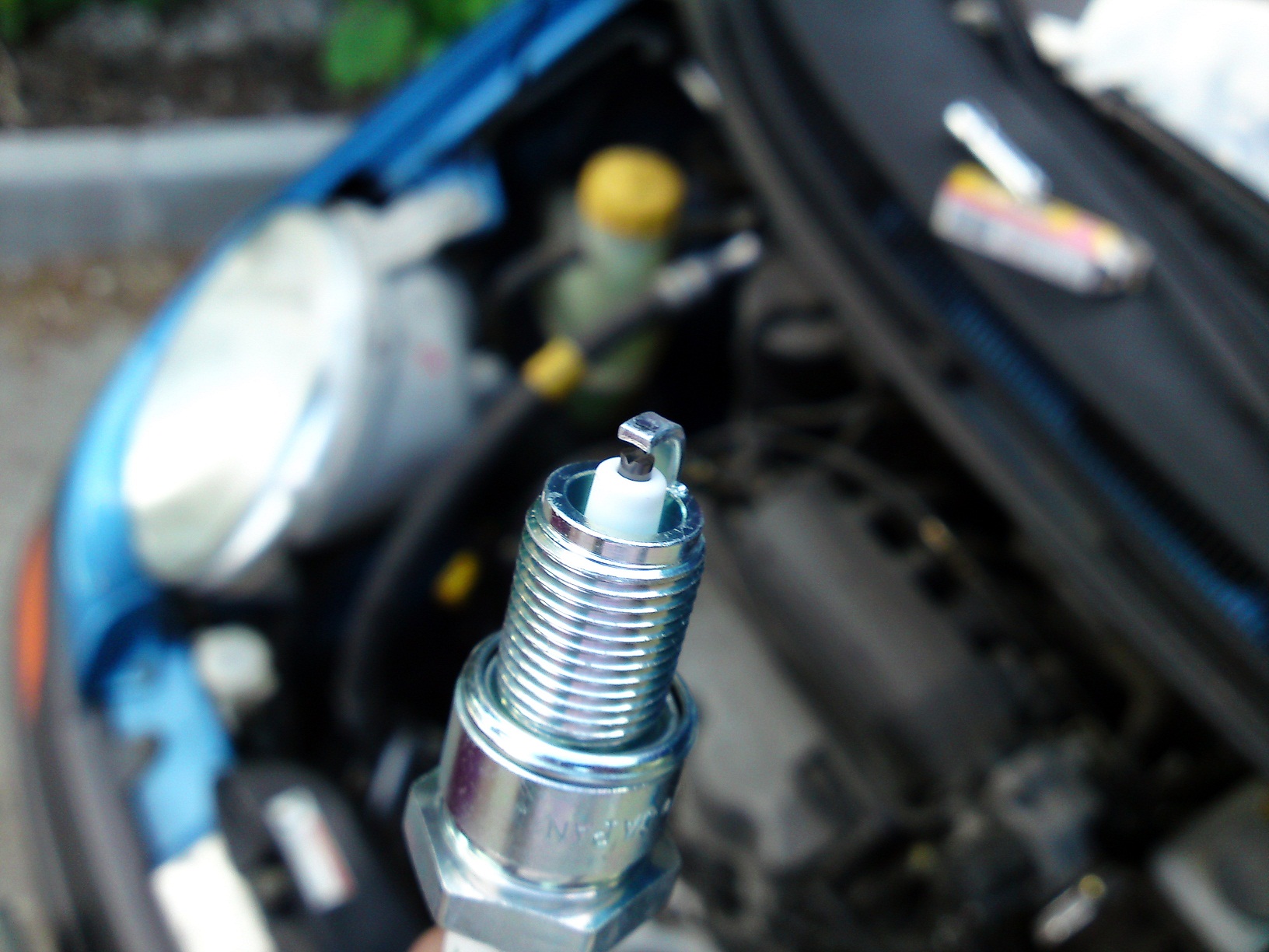

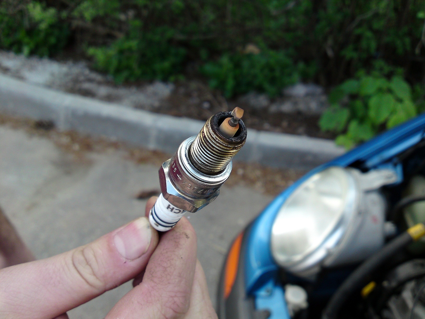

argon Posted February 9, 2011 Share Posted February 9, 2011 A mele aratau asa Si NGK asa 1 Link to comment
