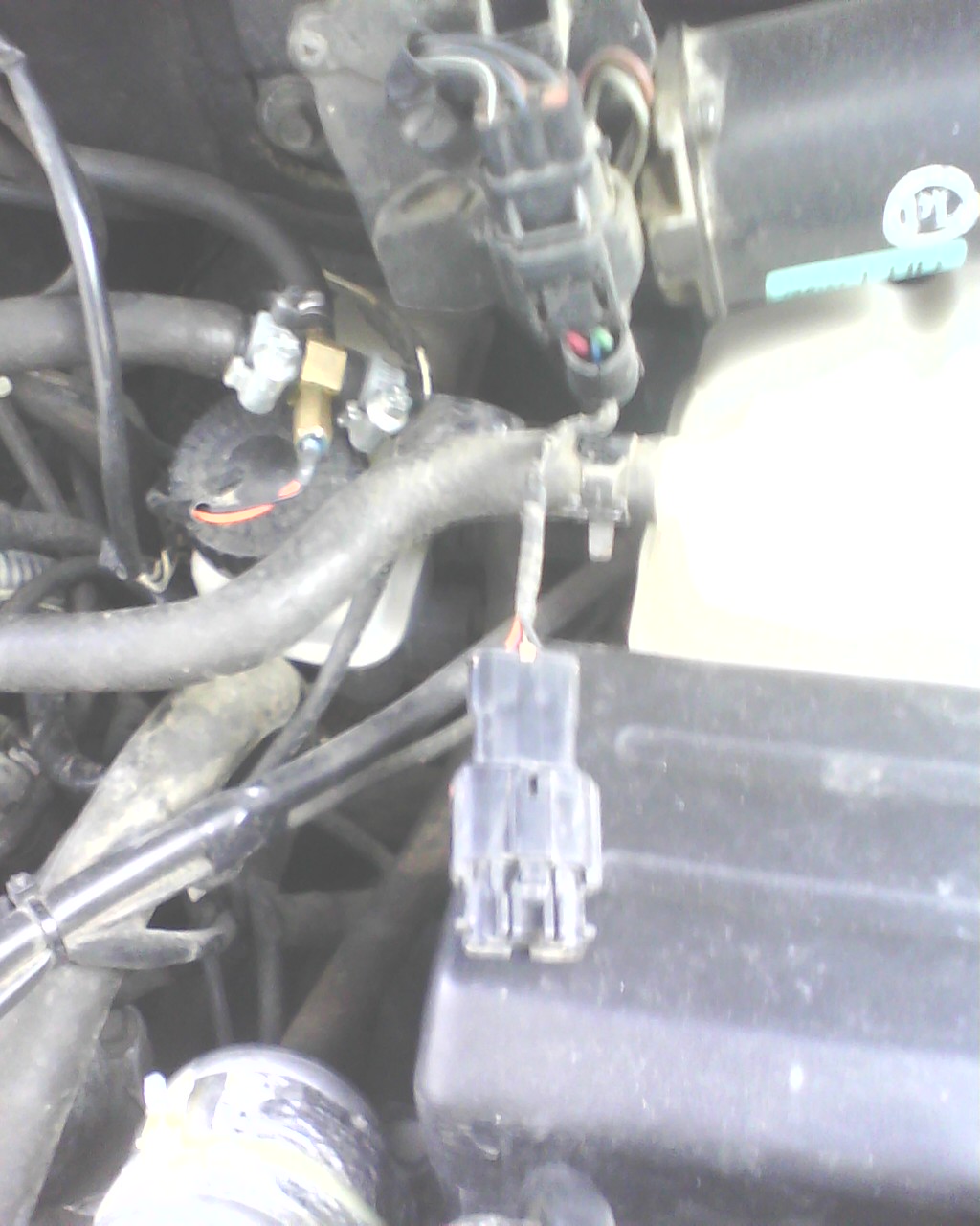

tobyas Posted February 1, 2011 Share Posted February 1, 2011 va rog sa-mi spuneti daca acesta din poza este jumperul de co ppentru ca la mine nu are eticheta iar sub vasul de expansiune nu mai este ceva asemanator.multumesc. Link to comment
Johnny_L Posted February 1, 2011 Share Posted February 1, 2011 (edited) Da, acela este (vezi si poza 2 pagini in urma). LE: Adica vezi postul #2597 Edited February 1, 2011 by Johnny_L Link to comment
ciprian_nichita Posted February 1, 2011 Share Posted February 1, 2011 (edited) On 1/14/2011 at 12:05 PM, wwillym said: Jumperul de CO la modelul din 2007, arata asa, si este ascuns sub vasul de expansiune. ................................. Cel de la Kalos 2005 1.4 16 v este exact ca acesta. http://www.gmclub.ro/forum/index.php?app=core&module=attach§ion=attach&attach_rel_module=post&attach_id=71480 Edited February 1, 2011 by ciprian_nichita Link to comment
