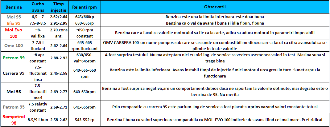

dadu1976 Posted April 7, 2008 Share Posted April 7, 2008 (edited) Am primit un mail cu asta Edited April 7, 2008 by dadu1976 Link to comment
Tommy Posted April 7, 2008 Share Posted April 7, 2008 (edited) Incantat. Cine a facut testul si pe ce motor? Edited April 7, 2008 by Tommy Link to comment
EM!L Posted April 7, 2008 Share Posted April 7, 2008 Nu-s cam mici valorile de la ralanti? 54x-64x rpm Link to comment
