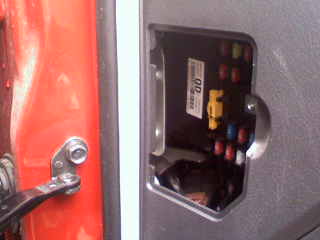

tolin Posted April 14, 2008 Share Posted April 14, 2008 Alte posibilitati sunt sub RON91, adica neindicat si neinteresant. Te rog, pune si o poza cu schema de pe capacul cutiei interioare de sigurante. Link to comment

puchi Posted April 15, 2008 Share Posted April 15, 2008 Tolin !.pozele cu capacul sigurante interior .Si ramane aceasi rugaminte.Mersii Link to comment
closchkutza Posted April 15, 2008 Share Posted April 15, 2008 (edited) Siguranta este aia, pe care o aveai scoasa pe pagina din urma. Scrie clar ECM ca desenul ala de pe capac. Edited April 15, 2008 by VAXXi Link to comment
puchi Posted April 15, 2008 Share Posted April 15, 2008 (edited) Multumesc dar scrie E.C.U .Banuiesc ca este siguranta de la E.c.m .Dar o intrebare nu strica ,si mai ales de la un cunoscator Edited April 15, 2008 by VAXXi Link to comment
tolin Posted April 15, 2008 Share Posted April 15, 2008 @puchi > au fost colegii mai rapizi si ti-au raspuns. Link to comment
Satori Posted April 15, 2008 Share Posted April 15, 2008 ECU - Engine Control Unit ECM - Electronic Control Module ECM poate sa stocheze si alte chestii, nelegate de motor. Eu asa inteleg. Oricum, in cazul nostru, e aceiasi mancare de peste. Link to comment
