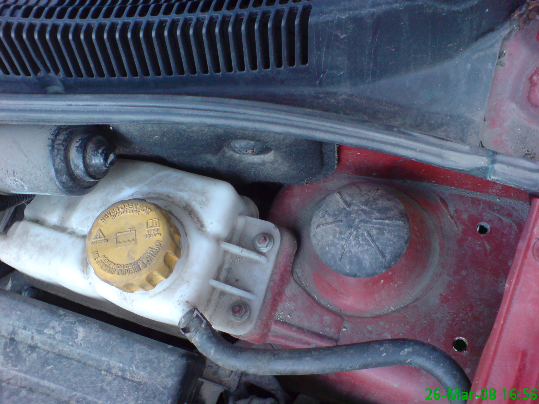

Raresh20 Posted January 18, 2009 Share Posted January 18, 2009 Uite la un Kalos unde e,parca si la Aveo e tot acolo,nu mai tin minte.. Link to comment
tolin Posted January 18, 2009 Share Posted January 18, 2009 (edited) Pentru ce trebuie poze, indicatia "sub vasul de expansiune" nu-i suficienta ? Cititi topicul, nu mai puneti intrebari la care s-a raspuns demult. Si nu trebuie bagata mana ca ginecologul, se desfac cele doua piulite si ... Edited January 18, 2009 by tolin Link to comment
