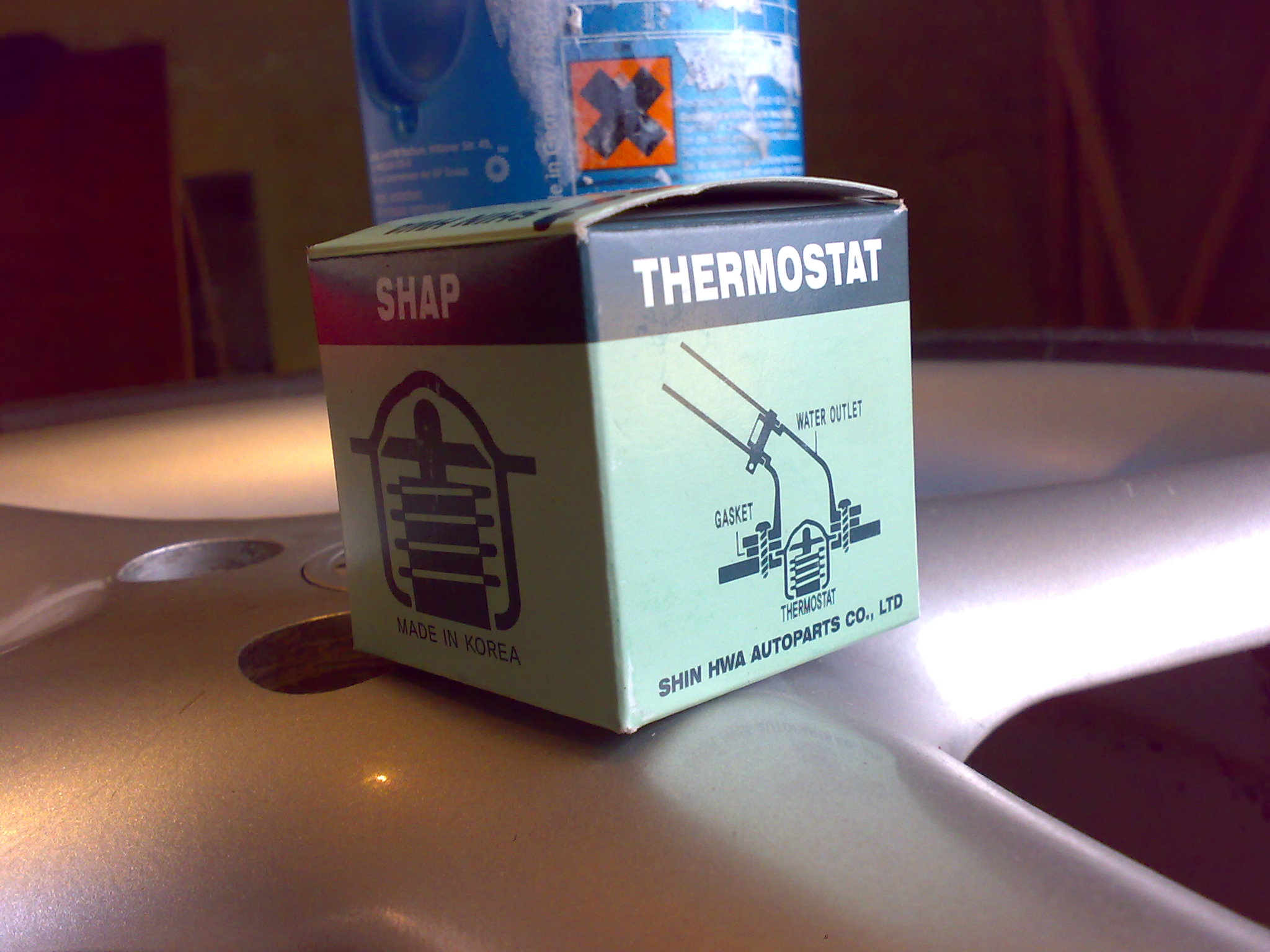

argon Posted January 6, 2011 Share Posted January 6, 2011 EU am luat de asta si e foarte bun, are si garnitura in cutie. Link to comment
korydon Posted January 7, 2011 Share Posted January 7, 2011 (edited) Eu m-am ghidat dupa pret Si eu fac la fel, numai ca merg dupa principiul " ieftin si bun ". Exemplu de termostat ieftin si bun ( de care mi-am luat si eu ) puteti gasi la Tico-ul lui nt98adu. Edited January 7, 2011 by korydon Link to comment

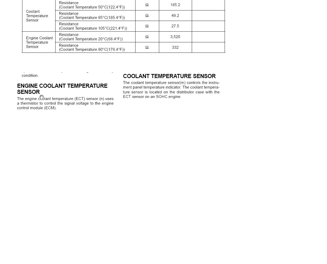

closchkutza Posted February 2, 2011 Share Posted February 2, 2011 (edited) In manual, pentru senzorul temperatura lichid racire, sunt date valorile in ohmi doar pentru 20 si 80 grade. Se poate remedia cu senzor de tico montat in loc. Acul va oscila in functie de cum porneste ventilatorul. Nu prea cred. Uite ce am gasit in manual: Edited February 2, 2011 by closchkutza Link to comment
tolin Posted February 2, 2011 Share Posted February 2, 2011 Prin urmare senzorul se va "bloca" (zero ohmi) pe la 125-130'C. Link to comment
augustinionut Posted February 2, 2011 Share Posted February 2, 2011 Perfect. Le-am inversat. Senzorul teperatura lichid racire cu senzorul temperatura lichid racire motor. Relatie temperatura-rezistenta, masurata de rusi: 0 grade celsius-66 ohmi 30-69 60-76 90-82 120 - 1989 150 - 1995 180 - 102 Se observa liniaritatea senzorului la temperaturi mari. Link to comment
