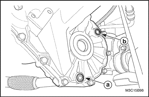

DevBreak Posted April 23, 2008 Author Share Posted April 23, 2008 (edited) Daca as sti unde este pozitionat acel buson cu cea mai amre placere. M-am uitat pe cartea tehnica este prezentat busonul insa nu l-am putut localiza Masina are 23.000 km mai este inca in rodaj cutia? Edited April 23, 2008 by DevBreak Link to comment
Mircea Posted April 23, 2008 Share Posted April 23, 2008 (edited) La 23k, nu mai poate fi vorba de rodaj... Devine insa foarte posibil sa ai ulei putin in cutie. Edited April 23, 2008 by Mircea Link to comment
DevBreak Posted April 23, 2008 Author Share Posted April 23, 2008 (edited) Spunemi mai exact unde este busonul de umplere pentru cutie, dupa manual nu imi dau seama Din cate am inteles eu este reperul #b insa nu il pot localiza Edited April 23, 2008 by DevBreak Link to comment
