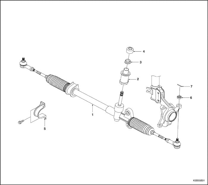

tolin Posted November 9, 2010 Share Posted November 9, 2010 - prima intrebare este retorica; - la a doua vine alta: are joc ? Link to comment
tolin Posted November 9, 2010 Share Posted November 9, 2010 Un pic de joc au toate, asta-i o calitate, nu un defect. Ca vorbeai de zgomote, priveste desenul urmator, ansamblul acela are un punct de sprijin intr-o ... bucsa. Link to comment
