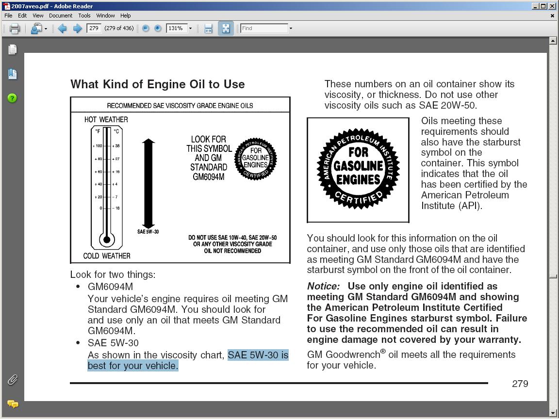

emathe Posted August 27, 2009 Share Posted August 27, 2009 Am sunat azi la un service Chevrolet, sa vad la ce pret au ulei GM 5w30. Au fost uimiti, de ce vreau sa pun asa ceva, ca asta se foloseste la masinile diesel, ei pun 5w40.Nu mai stiu ce sa cred, in carte scrie exact 5w30. Link to comment
tolin Posted August 27, 2009 Share Posted August 27, 2009 Asta scrie in Manualul de utilizare: "Do not use 10w40 ... or any other viscosity grade oil not recommended" Link to comment
