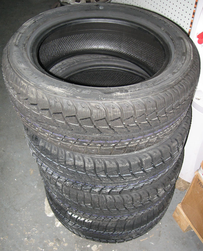

ratusca Posted November 27, 2008 Share Posted November 27, 2008 Pentru micul Aveo cauciucuri de iarna NanKang SV-1 185/55/15 - 210 RON/buc. cu montaj si echilibrare incluse. Link to comment
