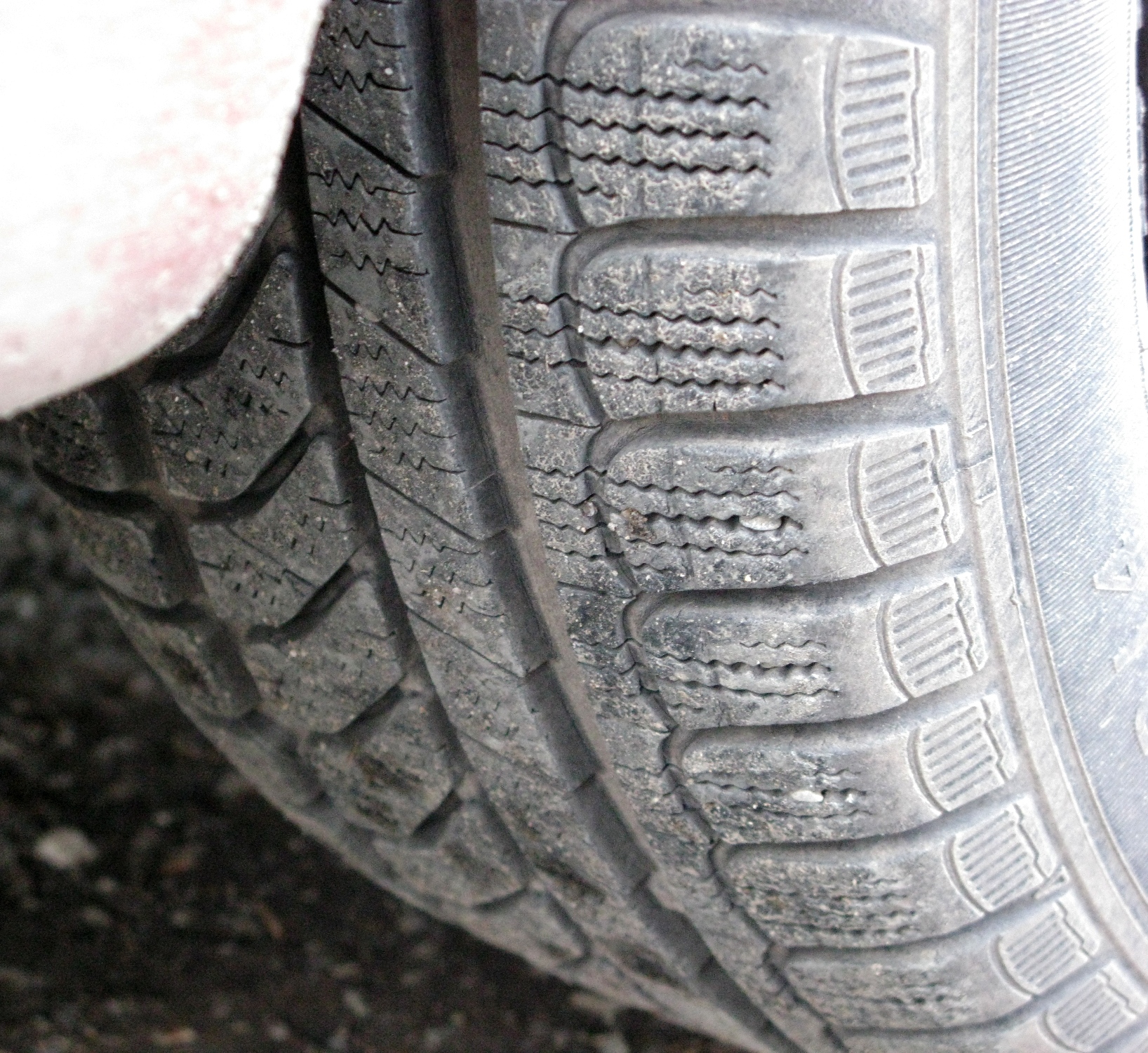

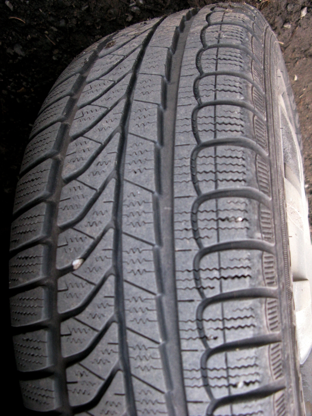

paul_marines Posted February 27, 2010 Share Posted February 27, 2010 Postez cateva imagini cu anvelopele de iarna dupa cca 25000 km. Adancime medie 6 mm din 8 mm maxim (nou) fata de 4 mm uzura maxima. Link to comment
