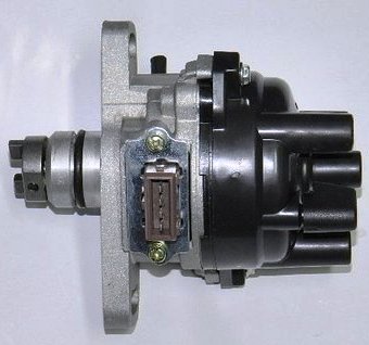

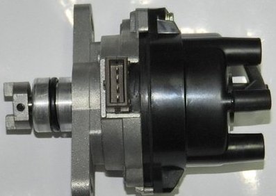

cornel83 Posted November 4, 2016 Share Posted November 4, 2016 Salut, Oare cum se diferentiaza? Dupa ce, ma poti ajuta te rog cu poze? Merci, Link to comment
buburuza vesela Posted November 4, 2016 Share Posted November 4, 2016 (edited) MANDO DAC Edited November 4, 2016 by buburuza vesela 1 Link to comment
cornel83 Posted November 4, 2016 Share Posted November 4, 2016 Merci mult, Concluzia e una ==> toate cele 3 delco-uri sunt MANDO poate de origine poate aftermarket se diferentiaza clar dupa capac si cel mai important dupa placuta prinsa prin 2 suruburi de la modul merci Desi am vazut ca in linck-ul transmis de mine este specificata obs. <<Reper aftermarket producator MANDO. Poza si descrierile sunt cu titlu informativ.>> Link to comment
