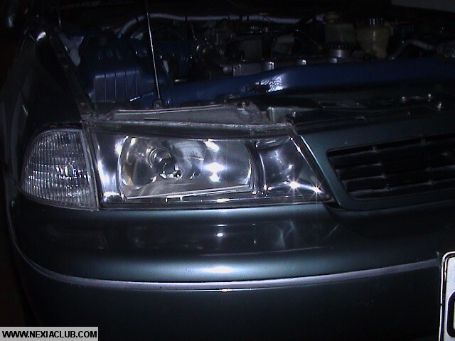

milosh Posted December 3, 2005 Share Posted December 3, 2005 someting from Poland www.nexiaclub.com/gallery.php Link to comment
dinoc Posted December 4, 2005 Share Posted December 4, 2005 Hi Milosh, Very nice auto headlight you have for you Nexia ! How did you succeed changing them ? I've noticed you have magnifying glass there ... do you have xenon HIDs too ? I'm interested to put some magnifying glass on my Nubira auto headlight if possible ... Dinu Link to comment
Vlad Posted December 4, 2005 Share Posted December 4, 2005 hello Milosh, VERYYY NICE..i have a cielo(nexia) and i want this type of headlights? where did you find it? Link to comment

Crista_Silviu Posted January 1, 2006 Share Posted January 1, 2006 Stie cineva daca exista posibilitatea de a pune geam clar la faruri de cielo? eu am gasit pe net un nexia care are montata o instalatie xenon cu geam clar si arata super. Link to comment
ovi_jer Posted January 13, 2006 Share Posted January 13, 2006 Ceea ce ai pus tu este defapt un far cu geam dispersor clar.Farurile tip proiector pentru xenon sant puse mai sus de userul milosh mai sus. Link to comment
Crista_Silviu Posted January 13, 2006 Share Posted January 13, 2006 Nu cred ca m-am exprimat corect ...Se poate schimba sticla originala ( cu dispersie ) cu una clara ( fara dispersie ), la fel ca in poza atasata de mine mai sus? Intreb asta deoarece un bec BlueVision se vede mai frumos (mai albastru) prin geam clar. Link to comment
