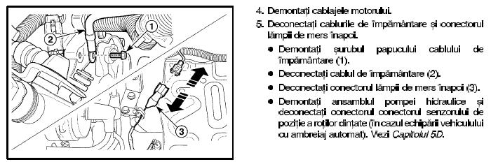

FLEX Posted February 11, 2005 Share Posted February 11, 2005 Uite poza, insa nu-mi dau seama foarte exact unde e localizat. Link to comment
