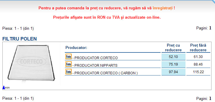

mortymer Posted July 28, 2009 Share Posted July 28, 2009 Cel mai ieftin www.rokor.ro multumesc mult pentru promptitudinea raspunsului dar prefer un magazin in bucuresti... Link to comment
ratusca Posted July 28, 2009 Share Posted July 28, 2009 Auto Karma, am luat pentru cineva Nipparts, si l-am si montat. Link to comment
Lucian M Posted July 28, 2009 Share Posted July 28, 2009 (edited) Ala cu carbon e la acelasi pret ca la service. Cu ce ma avantajeaza sa iau de acolo? Mai platesc si transport degeaba. Edited July 28, 2009 by Lucian M Link to comment
