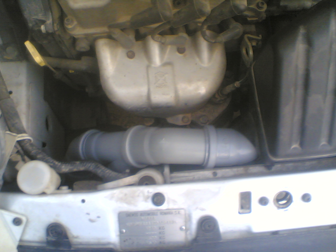

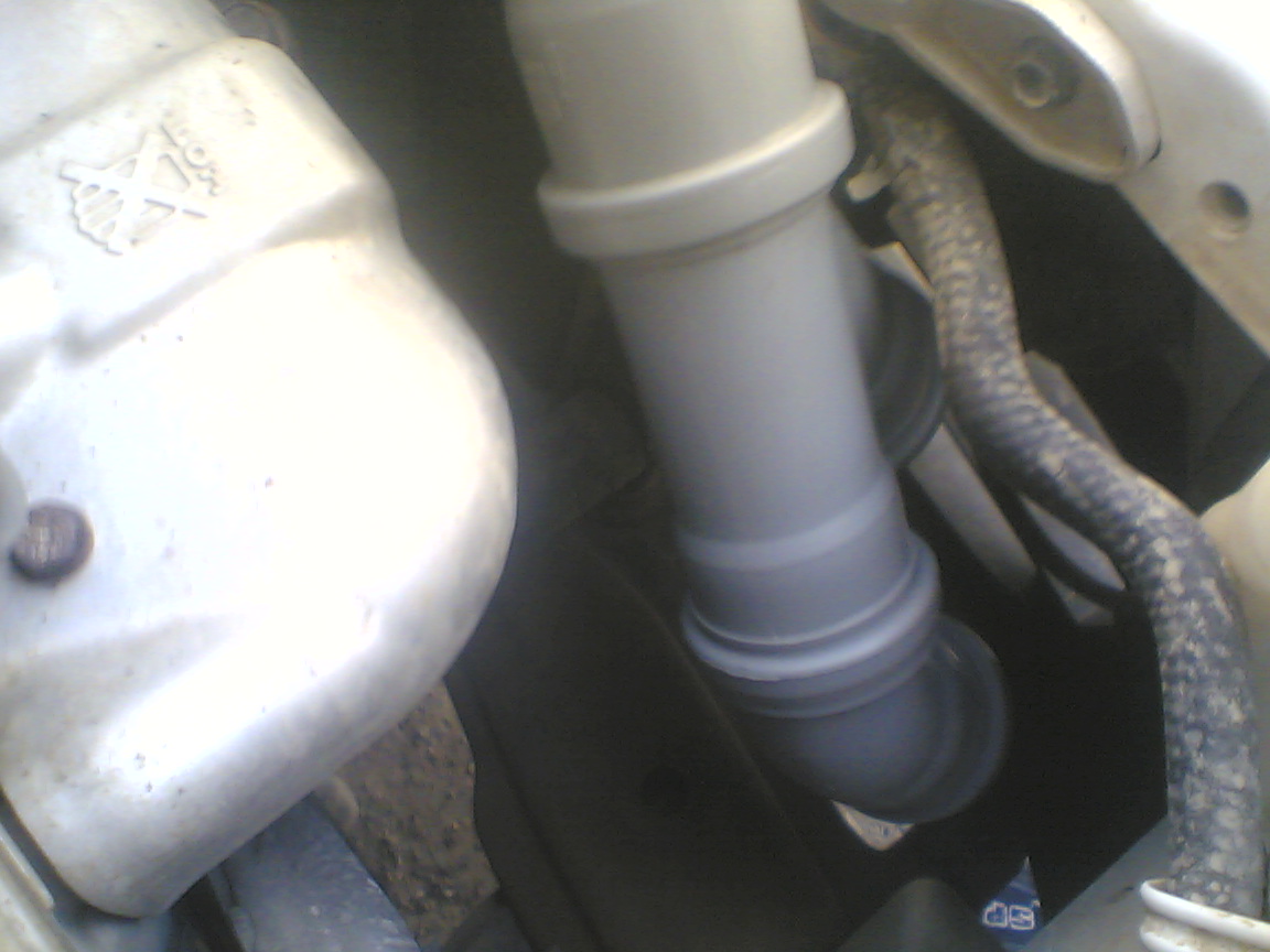

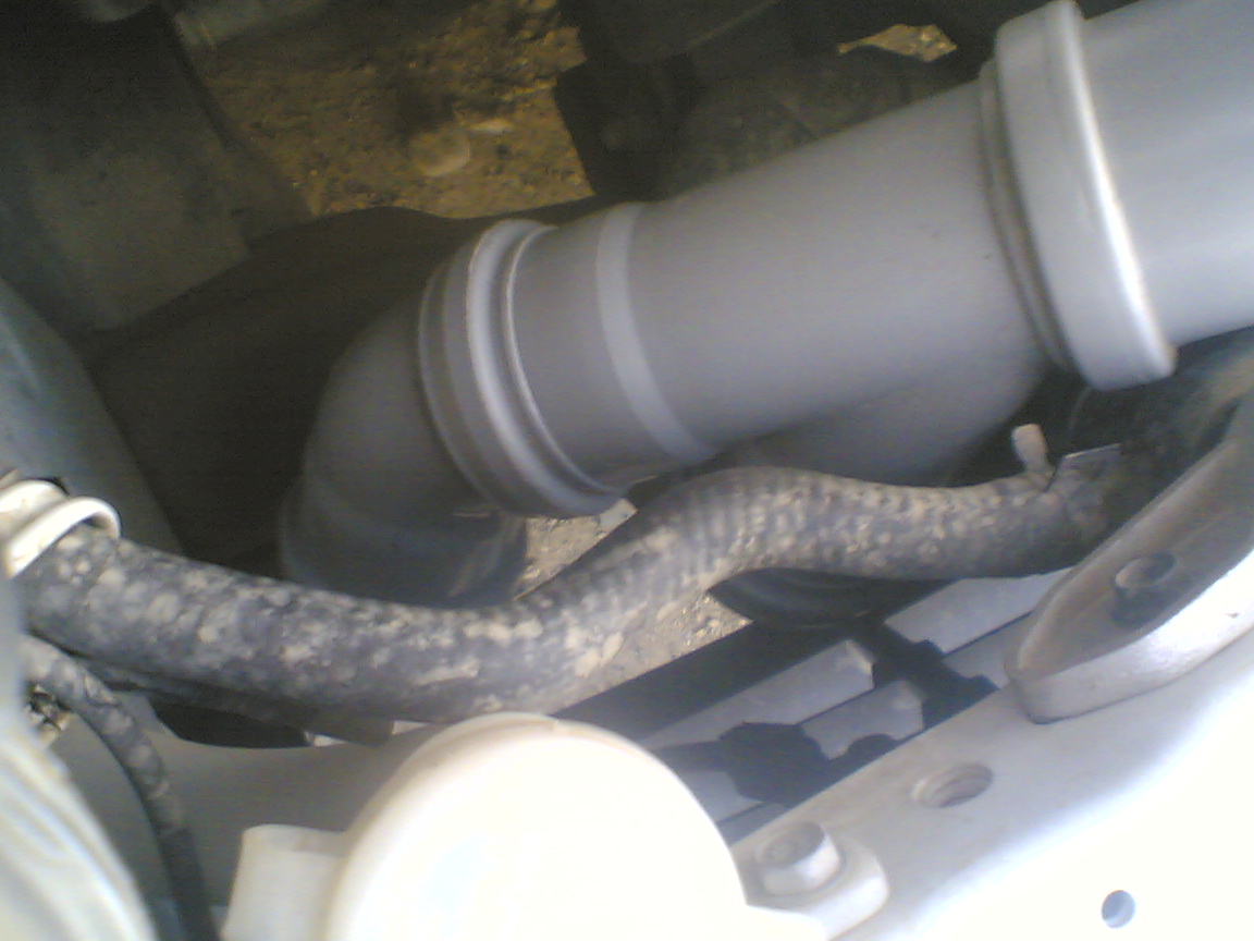

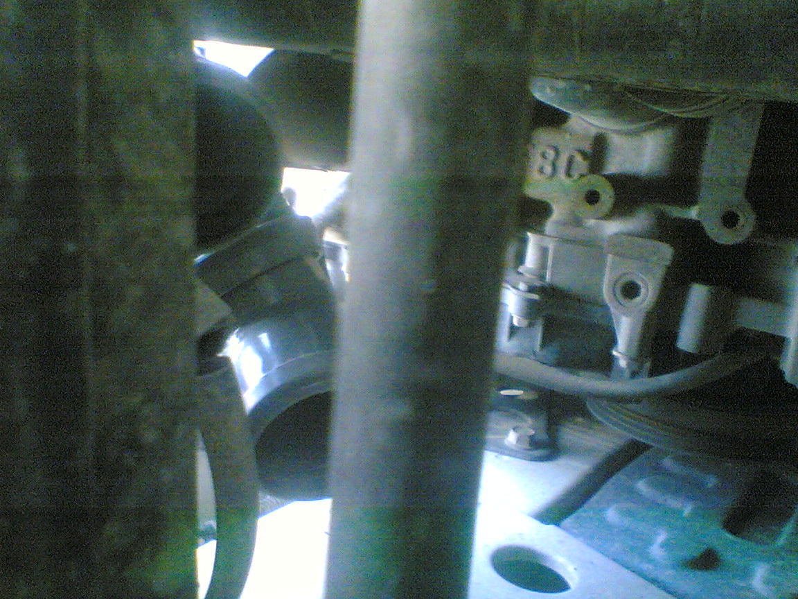

augustinionut Posted July 19, 2009 Author Share Posted July 19, 2009 Incuietoarea dreapta merge greu, d-aia sare tumburucu inapoi(actuatorul) .Si doar am dat cu sprayu... merge ca dracu. Merge binisor Am bagat sprayu prin gaura cheii Plus o magarie pt aer rece(adica tot cald, tevile , rezonatoru si cutia filtrului se incalzesc ca dracu) . Link to comment
tolin Posted July 19, 2009 Share Posted July 19, 2009 Plasticul ala nu rezista, se topeste. Pune un racord flexibil din Al de 60 mm. Link to comment
augustinionut Posted July 19, 2009 Author Share Posted July 19, 2009 Yes sir ! Cand se indoaie il atac.Cre ca sar si peste rezonator...dupa revizie . Link to comment
tolin Posted July 19, 2009 Share Posted July 19, 2009 (edited) Inainte ce are, crezi ca intereseaza pe cineva ? Tubul de 60 intra bine peste mufa de intrare de la filtru. Mai pui un colier, dar nu strangi tare, crapa tubul de ABS (plastic). Edited July 19, 2009 by tolin Link to comment
