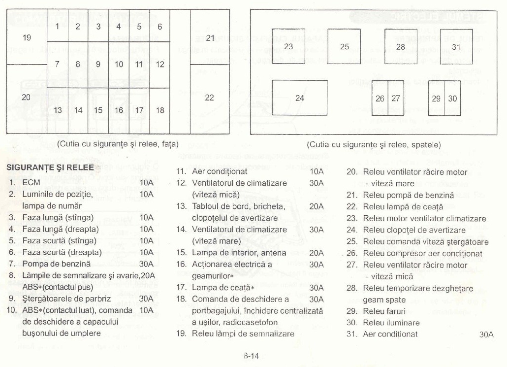

raduflavius Posted January 10, 2011 Share Posted January 10, 2011 stie cineva unde este siguranta de la avarii ca nu mai merg si in carte nu imi arata nimik, de asemenea nu merge nici ceasu de bord lampa ceata spate si bec portbagaj . Multumesc Link to comment
Viktor Posted January 10, 2011 Share Posted January 10, 2011 Tabloul de sigurante se gaseste in partea stinga a bordului, jos la picioare. Link to comment
