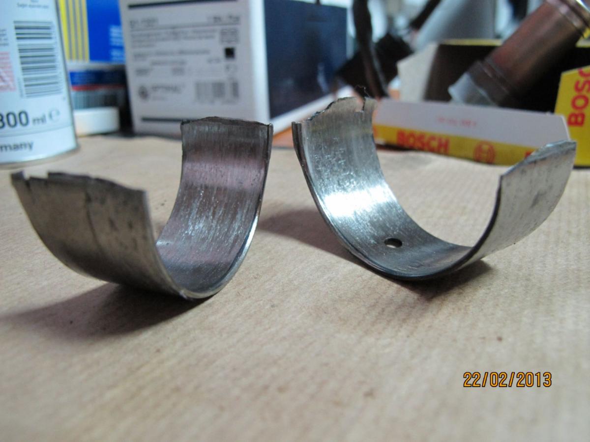

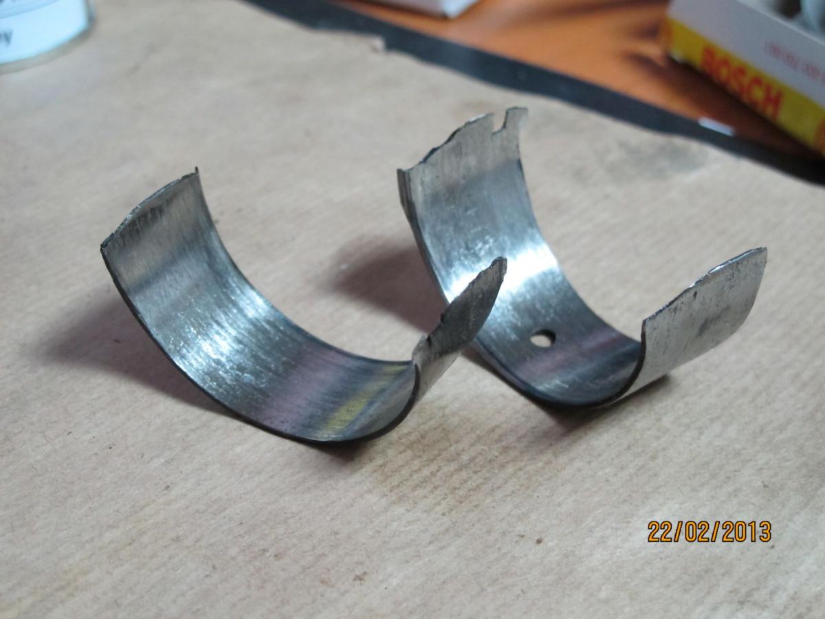

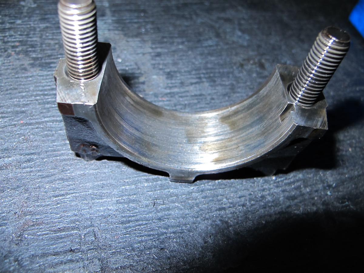

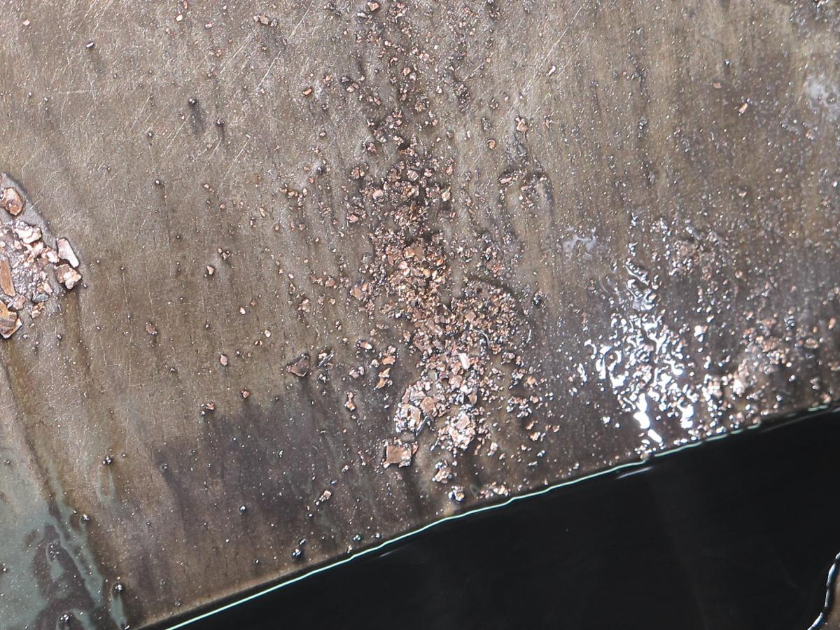

Salex Posted February 21, 2013 Author Share Posted February 21, 2013 Inca nu dar cam suna a biela ... Link to comment

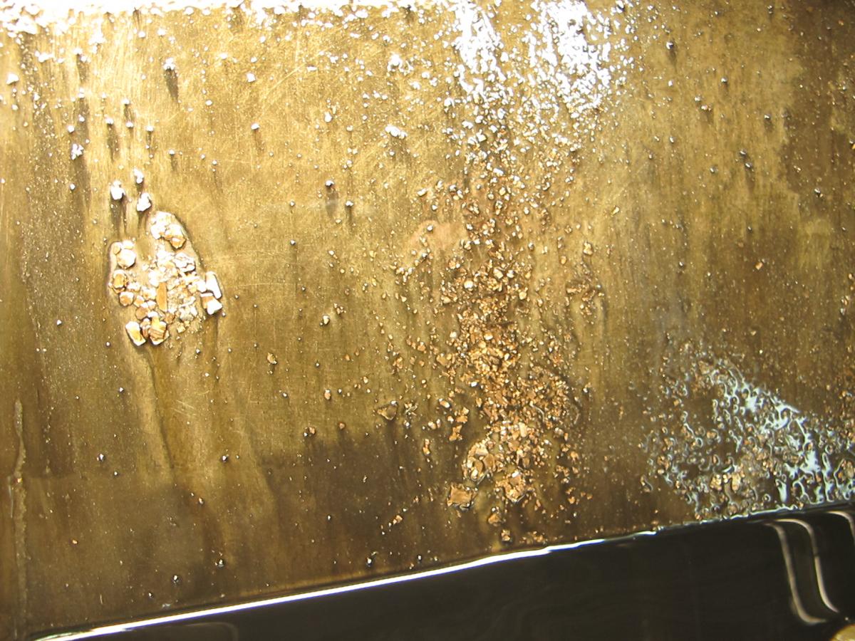

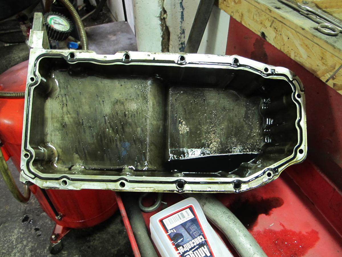

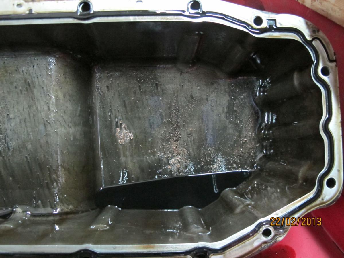

Pepinno Posted February 22, 2013 Share Posted February 22, 2013 Sant bogat!!!!!!! ....am gasit cupru sau alama...dar nu la baia de arama sau in vre-o mina....ci in baia de leganza.... Link to comment

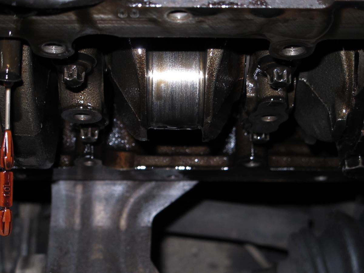

Salex Posted February 22, 2013 Author Share Posted February 22, 2013 Deci ... am avut amindoi dreptate . Desi, eu ma asteptam la a doua biela ... Totusi, e clar, trebuie sa schimb uleiul, nu face fata la solicitari ... prea intense )"> Link to comment
Salex Posted February 22, 2013 Author Share Posted February 22, 2013 GM dexos2, completat cu Mobil. Dupa inteventia de la inceputul lunii segmentii nu au apucat sa se aseze asa ca papa ulei destul de mult. Link to comment
Pepinno Posted February 22, 2013 Share Posted February 22, 2013 am totusi o temere ca vibrochenul nu a trecut testul...trebuie masurat... Link to comment
florinellll Posted February 22, 2013 Share Posted February 22, 2013 On 2/22/2013 at 10:33 AM, Pepinno said: am totusi o temere ca vibrochenul nu a trecut testul...trebuie masurat... Parca au la Radacini la 360lei nou Link to comment
Dj_Dark Posted February 22, 2013 Share Posted February 22, 2013 http://www.pieseautoradacini.ro/motor/25762-Arbore-cotit-Leganza.html La banii astia eu l-as schimba fara discutie, indiferent de rezultatul masuratorii. Link to comment

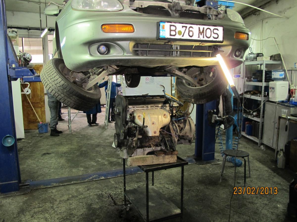

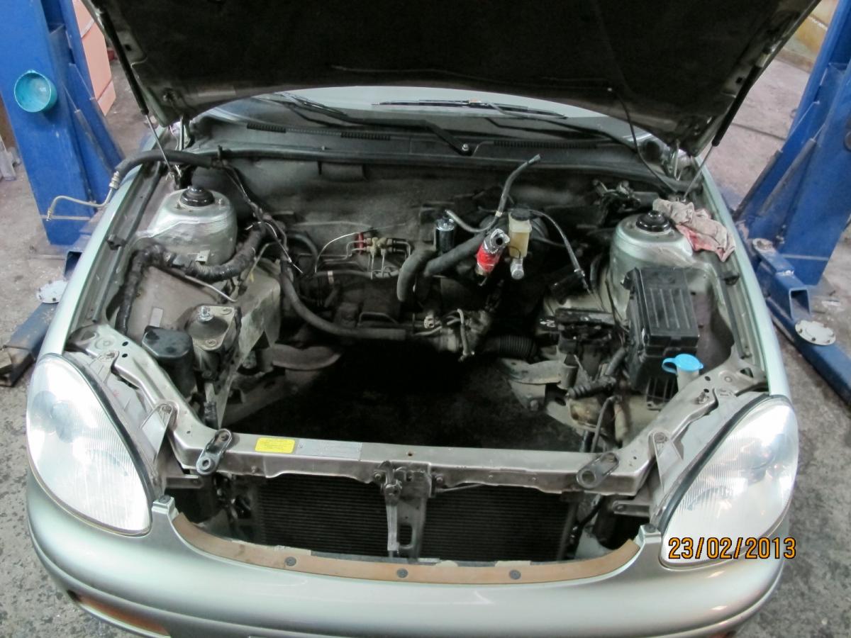

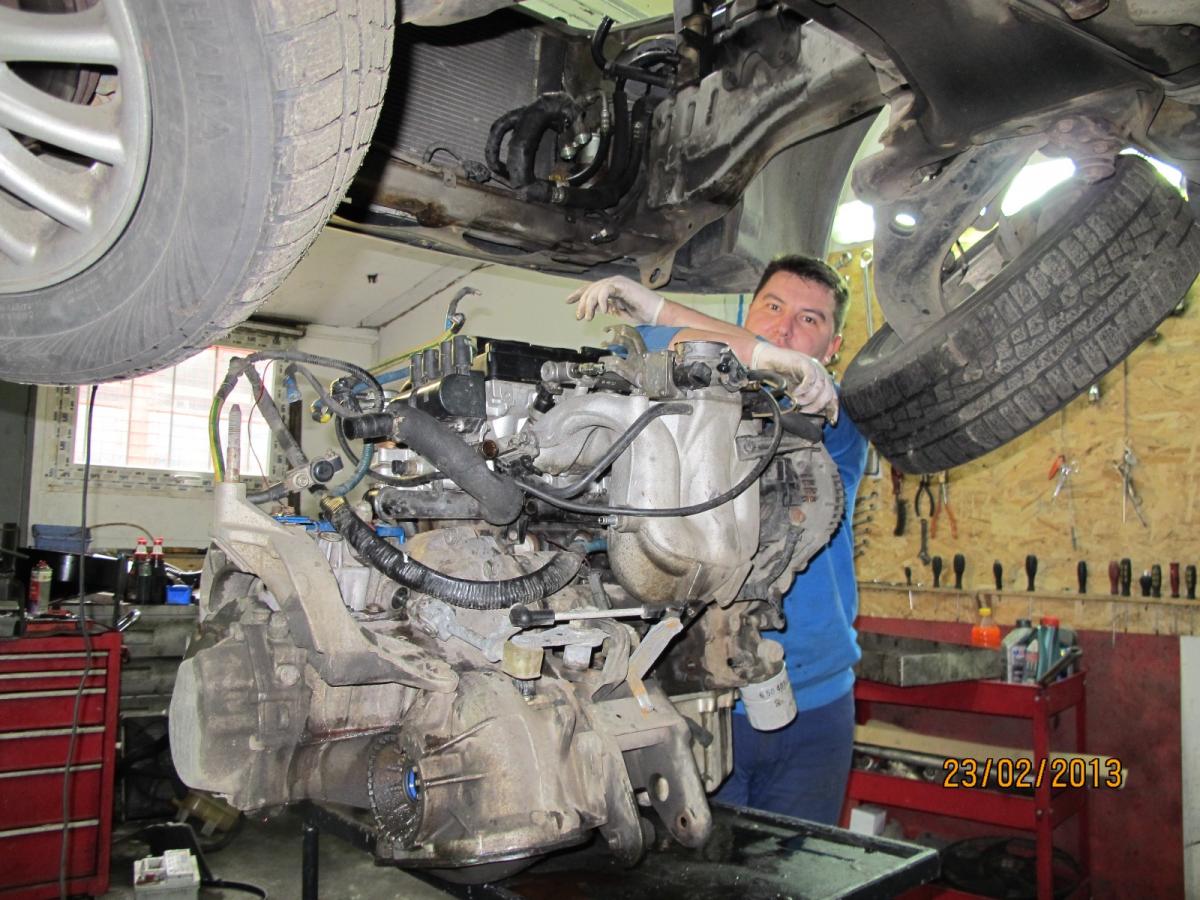

Pepinno Posted February 23, 2013 Share Posted February 23, 2013 un brat de fire...sa bag cateru`n ele? vinovatul...HOT ! HOT ! HOT ! L-am dovedit...!!....te astept cu material de lucru.. .......si o mare gaura... 2 Link to comment
florinellll Posted February 23, 2013 Share Posted February 23, 2013 Vad ca ati desfacut masina de pe motor ,pardon motorul de pe masina Link to comment
MCojo Posted February 23, 2013 Share Posted February 23, 2013 Ups, i-au cazut rotile... P.S. Pepinoooo ce te schimbasi bre... Link to comment
Pepinno Posted February 24, 2013 Share Posted February 24, 2013 pai ma au trecut ceva ani peste noi decand nu ne-am mai vazut..... .....Ps: asa bosorog arat..... Link to comment
MCojo Posted February 24, 2013 Share Posted February 24, 2013 OFF : Nu bre, nu bosorog... se vede pe fata ta viata de familie... ) Link to comment
