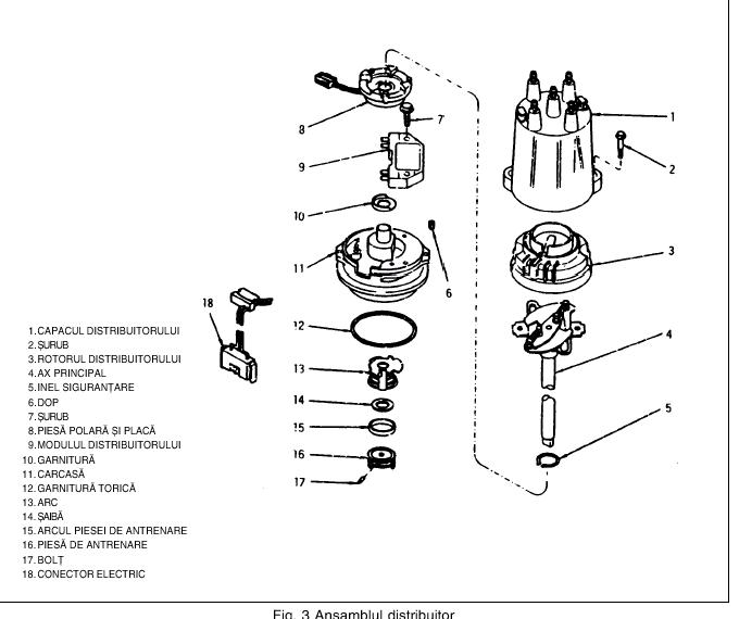

Esperatul Posted November 28, 2007 Share Posted November 28, 2007 A schimbat cineva la Espero 1.8 bobina de la delcou singur sa-mi zica si mie cum se demonteaza treaba aia de vine deasupra ei? Link to comment
Dj_Dark Posted November 28, 2007 Share Posted November 28, 2007 (edited) Daca delco-ul este identic ca la 1.5,cred ca e cel putin asemanator, trebuie dat jos cu un dorn pinul care prinde axul delco-ului de piesa antrenata de axa cu came a delco-ului si apoi iese magnetul de deasupra bobinei cu tot cu ax. Nu am manualul de service aici ca ti-as fi aratat exact in poza. LE A venit si poza, piesa 17. Edited November 28, 2007 by Dj_Dark Link to comment
Esperatul Posted November 28, 2007 Share Posted November 28, 2007 Merci, o sa incerc, daca nu reusesc voi merge la service. Link to comment
Dj_Dark Posted November 28, 2007 Share Posted November 28, 2007 Eu am reusit pe marginea drumului pe bordura. Dorn subtire sa intre acolo, ciocan si fara mila pana iese. E intepenit bine. Link to comment
